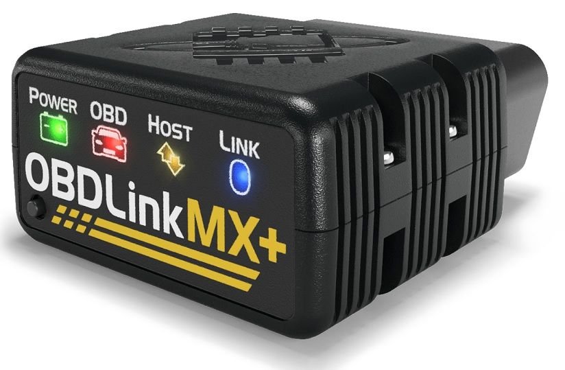

I have several OBD adapters and recommend the OBDLINK MX+. It is a bit expensive at around $140 and I do have much cheaper ones. I like that it auto powers up and down. Just seems to be a real solid device so far.
MX+ Adapter
MX+ Adapter
I agree. Use the same one.

The above MX+ is the same one I have as well. No issues with it shutting down and this does not drain my battery (2015 R). As for the phone, it’s an old Lenovo phone I got back in Hong Kong years ago. I had no use for it so just repurposed it.

The Veepeak OBDCheck BLE+plus drained my battery..had to do the disconnect/reboot thing. Just ordered the MX+ on Amazon...if it doesn't cause the battery issue...will be so happy on this end.

I bought the MX+ hoping it would solve my battery drain issues, but it did not. Same issue as with a cheap adapter. I also bought the iCarsoft scan tool and it causes the same issue. I have to do a battery disconnect every time I use the OBD port. Seems to be more about the car and OEM software than the OBD dongle.

I just got the MX+ and had the same issue.
It left the red triangle on - just plugged in (not using the dongle at all). And so it goes back to amazon.

The MX + will keep the red triangle on if you do not quit the Torgue app when you are leaving the car. In fact my car will wake up if I am near enough and open the Torque app with the dongle plugged in.

I manually close the app before I get out of the car on the android phone I use as a tablet for the app. I do unplug the MX + if I am not going to use the car for a few weeks because I am afraid I will forget it is there and break it off with my knee when I get back in. I don't touch the bluetooth settings on the phone.
