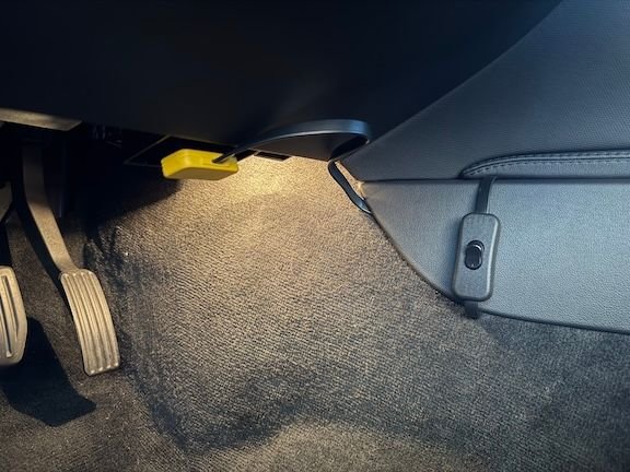

@John Coctostan I think this is the best looking solution, but it does not make a loud enough alarm noise to get my attention when music is playing. It was, however, nice to just get in the car and go without fiddling around, but...this is now my setup:
I replaced it with an Android phone running Torque Pro split screen with JBV1 with CSA paired to a V1 Gen2. I have the Torque Pro coolant and oil temp alarm set to flash at 220F and then a loud verbal warning with audible alarm at 230F. It will interrupt any music playing and get my attention quickly so I can pull over before the damage is done. JBV1 will announce laser and radar threats one mile ahead as well.
I have an inexpensive Veepeak OBD2 BT scanner with an on/off switch by my knee so it doesn't broadcast a BT signal while parked for battery drain and security purposes.
So there are some steps involved before driving the car (1-2 min), but worth it to avoid the permanent damage from overheating (many threads on the forum on the topic).

@JagCode3 Thanks so much for this info! Is the on/off switch integrated into your Veepak, or is it via some other piece of hardware?

@John Coctostan I use the yellow cable in post #8 above. Since the cable has slack the Veepeak is tucked underneath the driver's side carpet of the center console, and the physical switch is secured near my knee, all hidden. Just gently pry off the lateral plastic trim from the front end to access these spots.

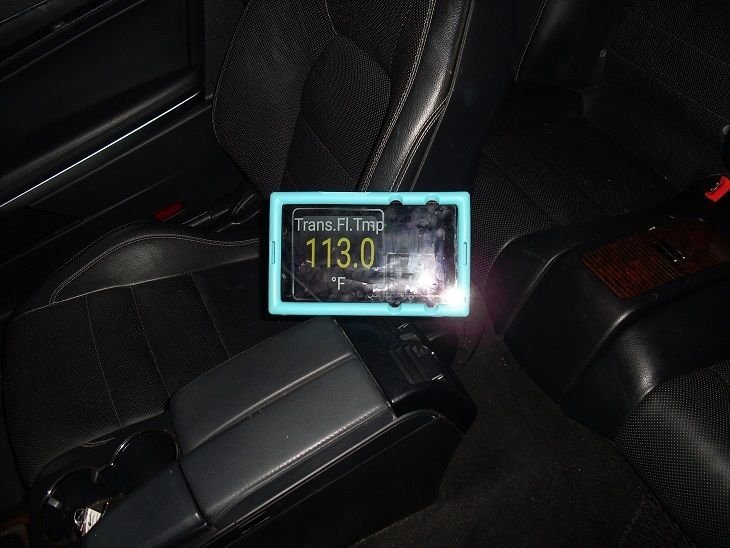

Sorry no I don't and that's probably the biggest drawback. That display is just on an 8" Android tablet. I don't have it mounted in the car as I use it in the shop too. Mainly for checking transmission fluid temperatures on these ZF transmissions. As you can see I have a large rubber case (Why it's Aqua in color and not black I don't know? A fashion statement I guess) for the tablet and it has survived a number of drops onto the concrete at least so far. Used it was only about $80 so a disposable tablet.

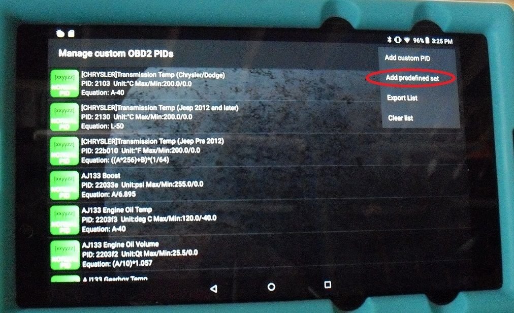

Just to add to how flexible Torque Pro is I also found and downloaded a Mercedes/Chrysler PID pack. Sorry the pictures of the screen are a bit blurry.
But the best use in the shop is setting up a custom 1 gauge screen for transmission oil temperatures. Now I can place the tablet out of harms way (Hot transmission fluid plus the car has to be running as well) so the temperature is displayed in a large and easy to read size.
So I can sit in the car (MB 350 convert) and read the temperature while the engine is running. Then while under the lift I place it where it's convenient to read while scrambling around getting that fill plug in BEFORE the transmission fluid gets too hot!! This is common for me and then I need to wait hours for everything to cool down and I can start all over. So I try to get it right on the first try!

@clubairth1 --- awesome info, thanks for sharing this. Love the thought of the big one trans temp gauge to help w/ ZF fluid change procedure.

Yea the whole mess of trying to balance aiming an IR gun on the dribbling hot fluid coming out of the fill port with the blazing hot exhaust inches from your head. ( I always wear leather gloves when doing this!). Then getting that small plug threaded back in with little room to do it!
With this all I need to worry about is waiting for the fluid to slow to a dribble at the right temperature range and getting the plug started.

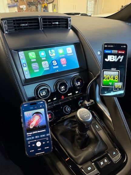

Old Jan 27, 2025 | 06:32 PM
  #35
JagCode3's Avatar
Joined: Jun 2024
Posts: 581
Likes: 284
From: SacTown
Here is my setup. I have a Scosche Magic Mount plugged into the lighter socket which also serves as a support for the Android phone. The iPhone is in a ProClip magsafe mount.

@JagCode3 Thank you!!! That's a good looking setup. I'm learning toward the Android phone Torque app solution.

@JagCode3 Dumb question: you don't have to be wifi hot spot tethered to your iPhone in order for the Torque app to work on the Moto phone, correct? i.e. the Torque app simply works via BT from the Veepak to the Moto phone, yes?

@John Coctostan Not dumb, that's a great question - Torque (like JBV1) does have some GPS requirements that require WiFi, but it will still connect automatically and report the values from the OBD2 scanner via BT. But since you have an iPhone just tether it because the data usage is minimal for these apps.
If you play music I don't recommend the Shadow - the audio alert is not loud enough. I drove with the radio off to enjoy the engine noise for the first 2 years with the F-Type so the Shadow worked well. However after upgrading my stereo I always have music playing so needed something to overcome that.
