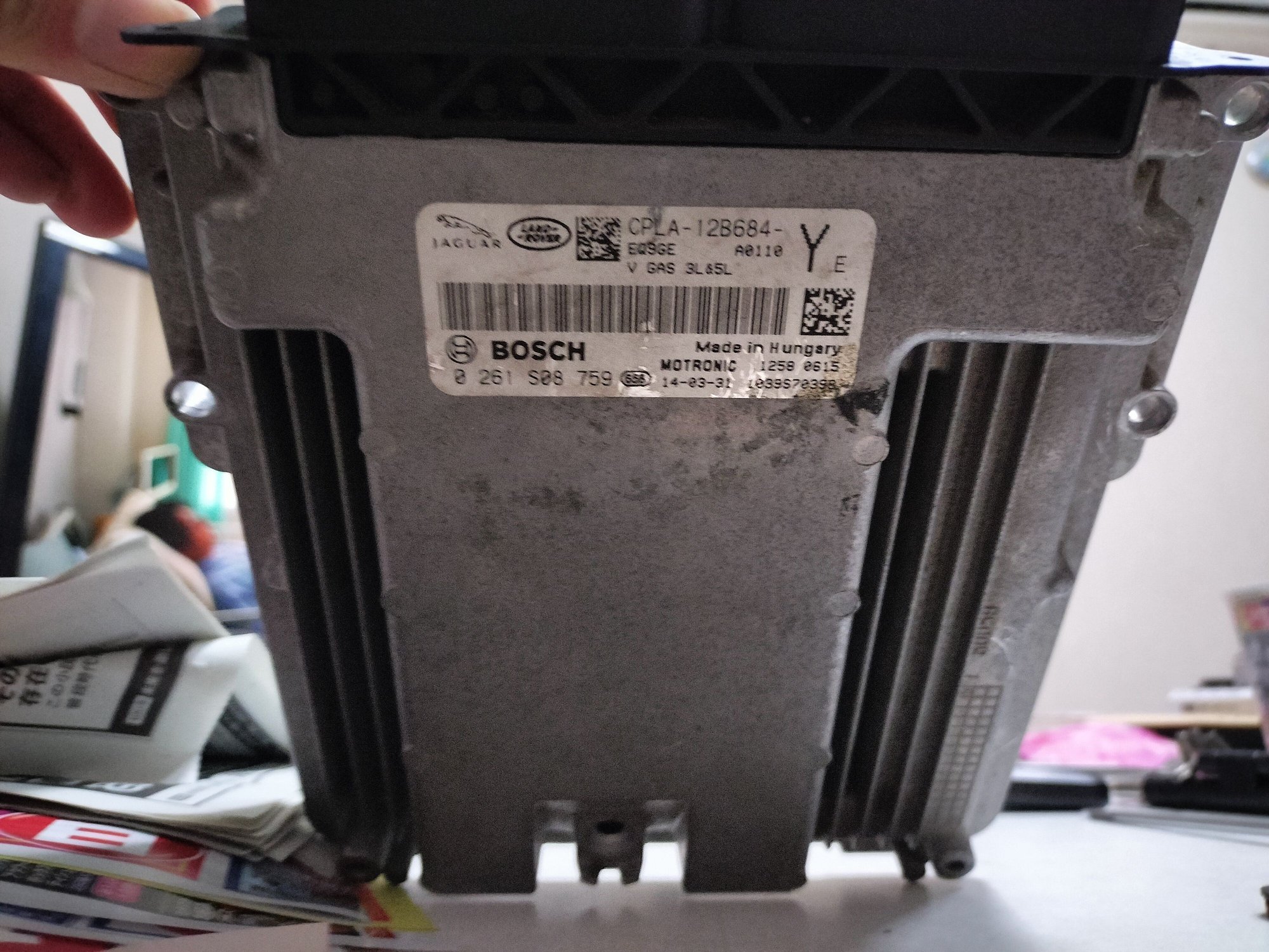

Thank you everyone. I removed the sensor and checked the continuity from the connector to the ECU connector, and one side had continuity with ECU connector number 54. The other side had continuity with the body ground. So I'm thinking it's an internal ECU problem, and I'm currently taking the ECU out and opening it up.

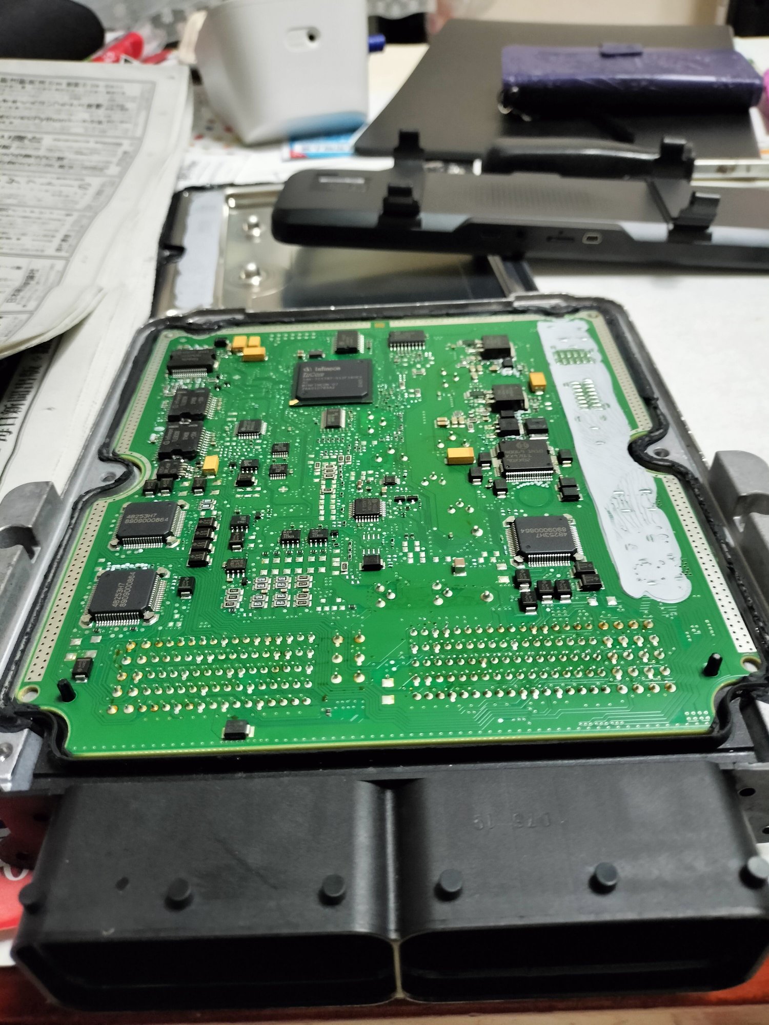

However, when I monitored the sensor temperature, it was 140 ℃. There is a short circuit somewhere. I removed the connector from the ECU and measured the continuity of the wiring with the sensor removed. There was no short circuit in the wiring. For some reason, terminal 54 on the ECU side (the positive side of the sensor terminal) was connected to the ground. I think it's a problem with the ECU. I've already opened it up and looked, but I don't know.

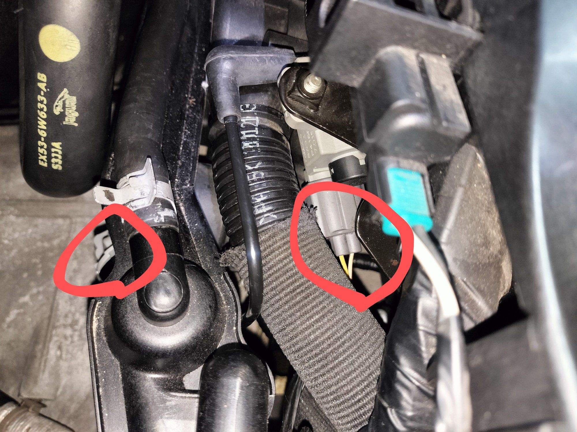

I finally solved it. The temperature sensor connector was plugged into another connector nearby. I don't know which idiot dealer did it, but I noticed it by looking at the wiring color. Thank you very much.
