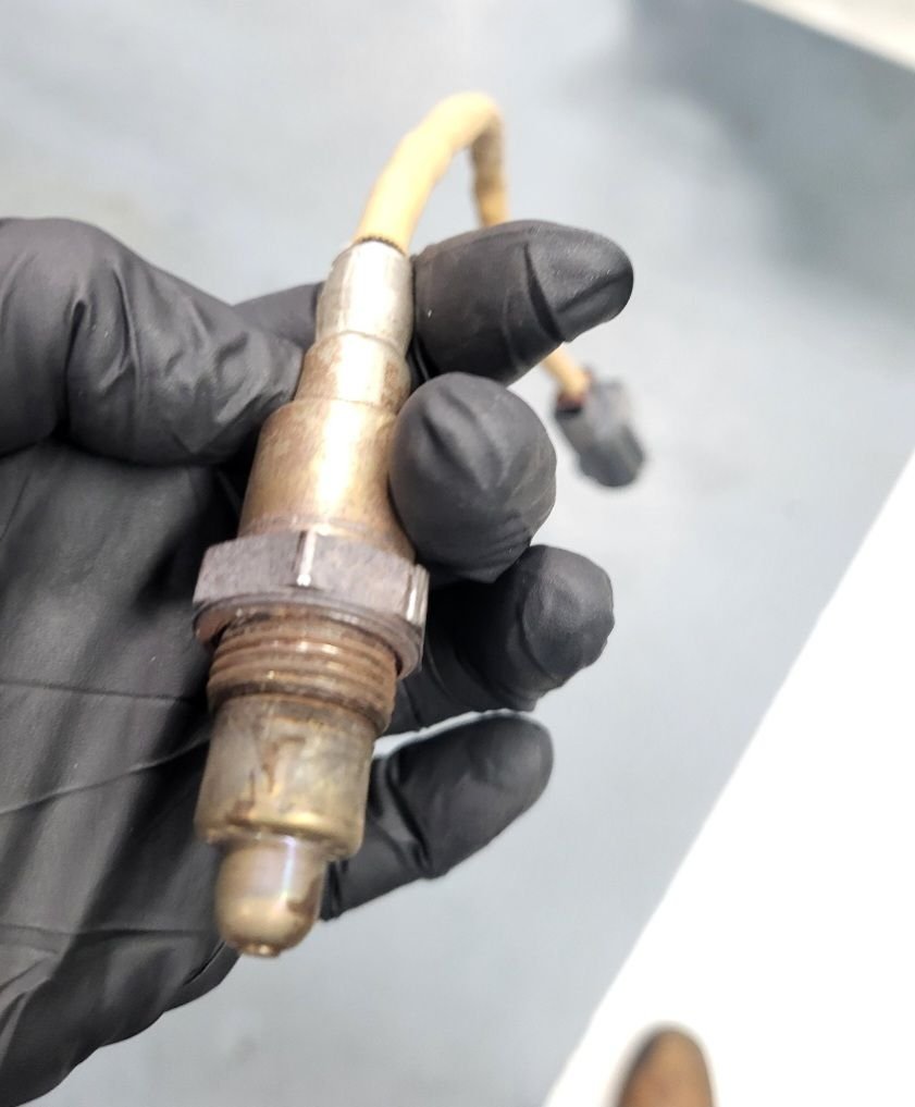

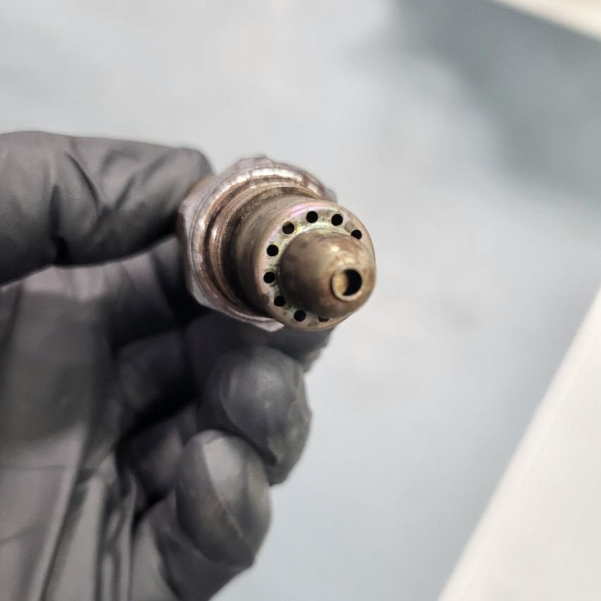

Well I can't see O2 sensors getting "washed" out by fuel?
I had an injector failure in my 5.0L XJR that flooded the engine with so much fuel I could not even start the car. After many hours of work and swapping injectors around I got it to start. Huge white clouds came out of the exhaust pipes. Took about 15 minutes of revving the engine to clear it all out. After all that the car ran fine. BUT now it was throwing Catalytic converter efficiency codes. Yep all that excessive fuel had ruined the drivers side cat!
I replaced the drivers side cat with a used one from a V-6 car. Turns out Jaguar again used a lot of the same parts between the V-6 and the V-8's. The exhaust system is one of them. After all that abuse I had zero O2 problems. They still worked just fine whether they were throwing cat codes or not! I know they were working OK because I swapped them side to side as I really did NOT want to replace that catalytic converter! Was hoping for a cheap fix with an O2 swap. But unfortunately the cat efficiency code stayed on the drivers side even after the O2 swap. Catalytic converters are $2400 each from JLR. I got a 65K mile used one for $500. Still a very expensive repair!
The O2 sensors are not too expensive and it might be a good idea to change them just because. Surprised they could not get the O2 sensors out? I have several special sockets and have never had one I could not remove. Now if talking about exhaust studs. Then yes I have fought those rusted things way more than I wanted to! Even though the O2 sensors are not suppose to need any anti-seize. I still (Old school I guess!) put a small dab on the threads. Old habits die hard.
Thanks for the reply. They're changing out all 6 of the O2 sensors (two of these will come with the new catalytic convertors) at no cost. Here's photo's the dealer sent me of the O2 sensor.

I had one O2 sensor replaced on my SVR a couple of years ago (covered by that extended warranty). They said it was a nightmare to get the old one out! I also did one on my Land Rover myself (it's got enough ground clearance that you can just reach under) and it came out pretty easily. So think it just depends on whether heat cycles and corrosion have welded them together...
