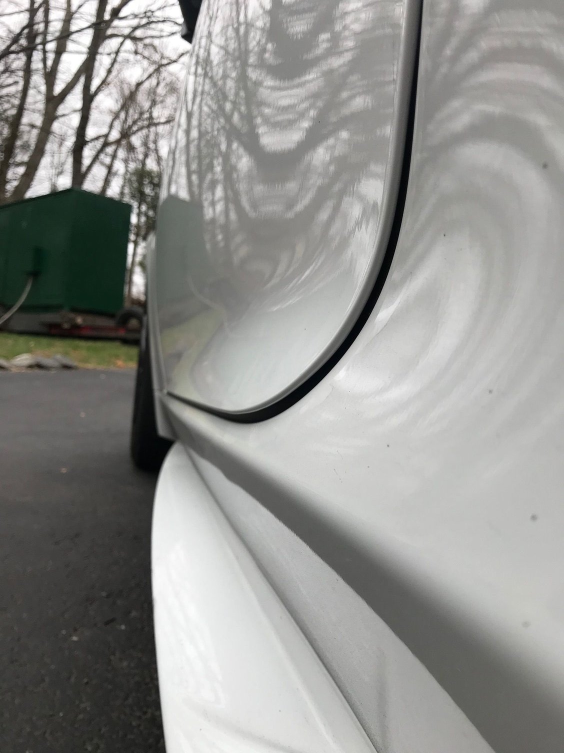

Apologies if my etiquette is off for bumping such an old thread, but the left door / sill alignment issue is exactly what I am experiencing with my new CPO 2017 with 12K on it. Did you get this resolved? If so, how? A couple forum members recommended adjusting the door latch inboard, but that had little effect on the area in question and misaligned the top edge of door.

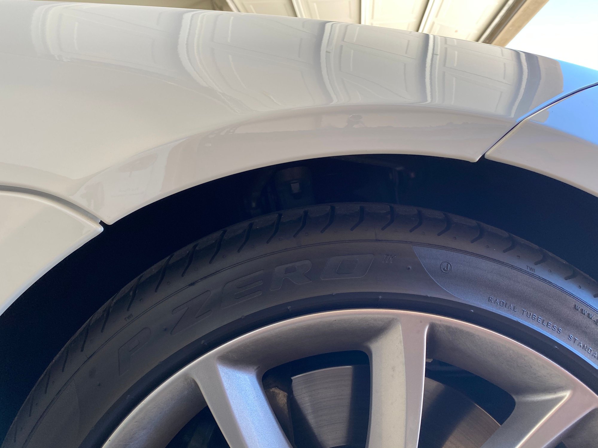

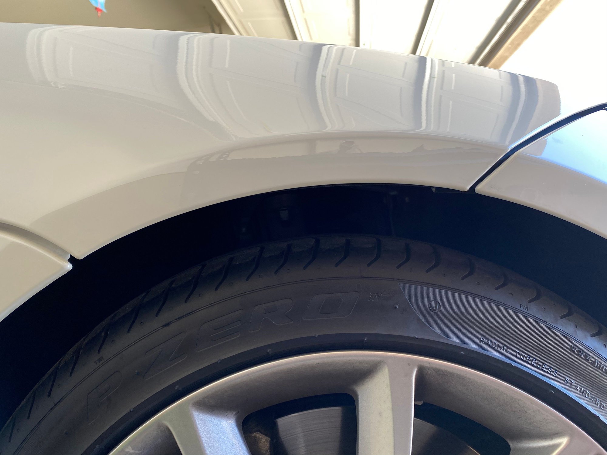

I had the same issue with panel gap inconsistency at the wheel arch. There are 4 bump stops that can be adjusted under the hood that can help correct this issue. The front two are the ones you will want to adjust. I was surprised how much I had to raise them. There is a TSB for this issue (you can google "JTB00399NAS1" for the document).
Before:
After:
I still need to make adjustments to make the gap consistent where the bumper meets the hood (near the light), but the wheel arch is looking much better.
Before:
After:
Looks muuuuch better. Will attend to mine soon.

What is a "TSB"? Is anyone aware of a fix for the bottom of the drivers door being proud by about 1/4"? (Picture earlier in thread) I tried the door latch adjustment someone here recommended, but that had minimal effect in the problem area and misaligned the top of the door. I've seen other Ftypes with same problem and i'm sure it's only us that notices it. But now that I know its there, it drives me nuts!!!!
