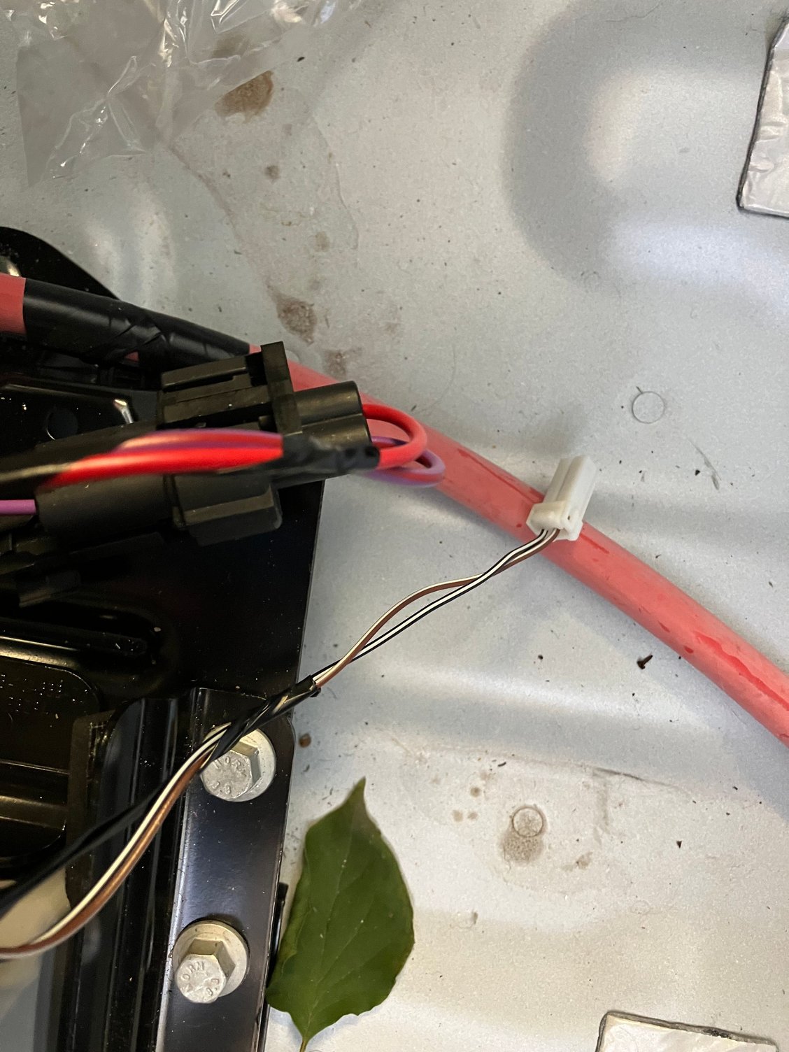

any other thoughts. When I changed the battery I noticed a loose wire. Near the positive terminal. Very small wires.

That white disconnected plug in the vicinity of the battery has been mentioned often here.
It is used by dealers after the car is transported to its 'new' home country.
PS: You need to rake those leaves in your trunk/boot, LOL.

Funny
I carefully vacuumed the trunk insert before installing it. The leaf will never be seen again.
Thank you Jaguar. I used the front access for the charging. Used a 12 volt power supply. No loss of any data.
