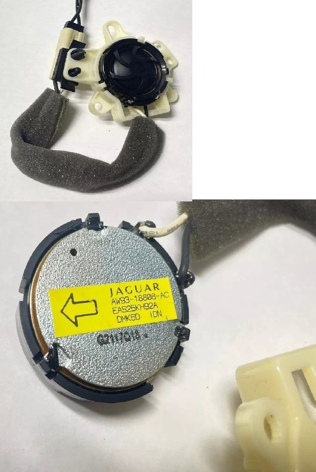

Hello all. I am in the process of doing speaker upgrades to my 2015 F-type S convertible with the 380W Meridian system. I have decided to go with OEM replacements for the speakers. I already have the CPLA-18808-JA mids to go in the doors. I am looking to purchase the titanium tweeters next and have a question on the ones I have found for sale. They are listed as AW93-18808- AC which is one of the correct model numbers, but the dome of the tweeter is black in color. The other titanium tweeters I have seen posted are .... titanium / silver in color. The grill of the tweeter is the same style as the titanium tweeters that I have seen in other posts with titanium color domes. I have attached a pic of one of the speakers in question. if anyone could confirm that it is a titanium tweeter, it would be helpful. Thank you.

Hi @SurfCat , here's a cross reference table for all the speakers fitted to the F-Type (Base, 380W and 770W all use the same speakers, just the extra centre co-axial on the 770W). The early Base models, didn't have the rear sub fitted, only the 3" mid for reverse sensor warning.
Here's the original tweeter (BJ32-18808-AC) on the left (silver cone), next to the Meridian Signature tweeter (AW93-18808-AC) on the right (black cone, spiral grille)
So yes, the black cone tweeter you have pictured is the upgraded titanium speaker (mostly sourced from XF or high end LR models with Meridian Signature system).
One or two owners who have done the speaker upgrade with OEM Jaguar Meridian Signature/Bowers & Wilkins speakers, report the titanium speaker can sound somewhat too sharp and 'tinny'. Personally I found it to be an improvement all round when I did the full upgrade. Hope you enjoy the improved audio, but word of advice, make the effort to sound proof the doors while you have the door cards off. The door cavity is quite large and acts as an amplifier for road noise, killing any efforts to tighten up the cabin audio. Well worth the extra effort
