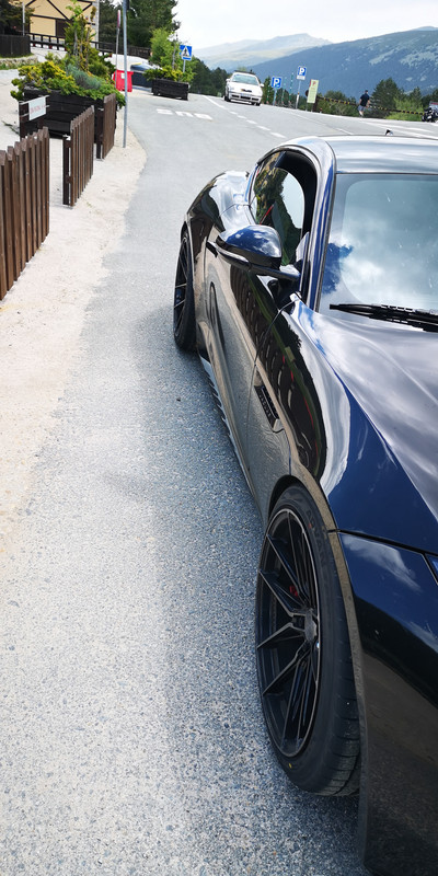

Those are some lovely looking rims! best i have seen so far. really dig that thin blade spoke look.
Personally i'd love a set of these on my car, with deeper concave!

FYI ray, this wheel style looks to be side specific. Either the fronts need to be swapped from one side to the other, or rear needs to be swapped so both front and rear match the rotational design.
yes they are! i ordered them that way ;p
when I picked up the car I noticed right away but were in a rush, they stayed that way the entire summer and i thought it was alright looking. next time around the rear will be facing the right way.
I also meant to weight these but laziness got the better of me, I have a new rear coming(one was badly bent and repaired, NYC road u know), I will weight it then and share the source if i like the weight.
It's deeper!
I was looking for the rims for a long time and in my opinion they fit the F-type like no other .
