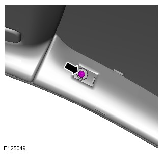

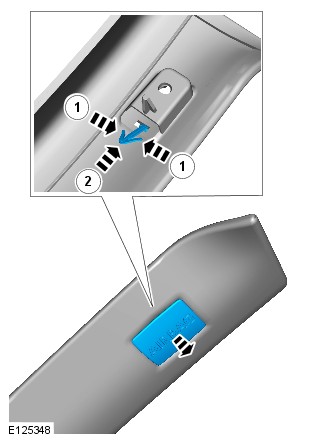

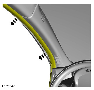

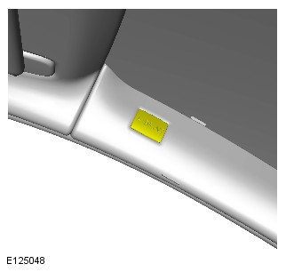

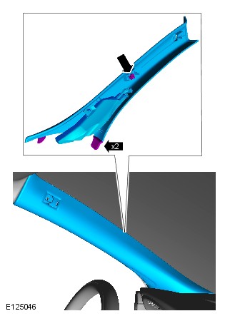

dear all,
Does anyone have some pictures on how I can disassemble the A-pillar trim ? I do not want to break anything !

REMOVAL
NOTE:Removal steps in this procedure may contain installation details.
  1. NOTE:Some variation in the illustrations may occur, but the essential information is always correct.
    Torque: 6Nm
  2. NOTES:
    • Do not disassemble further if the component is removed for access only.
    • Some variation in the illustrations may occur, but the essential information is always correct.
    • Note the fitted position of the component/s prior to removal.

Thank you very much, the pictures will help me a lot !
The last picture with the small plate ( airbag ) is not very clear.
But I think I just have to unclip this plate...
