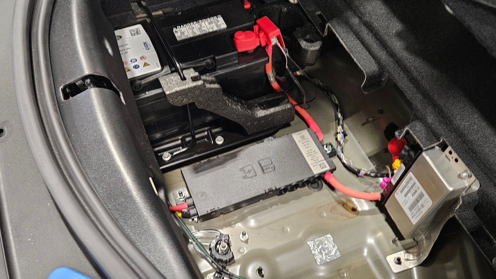

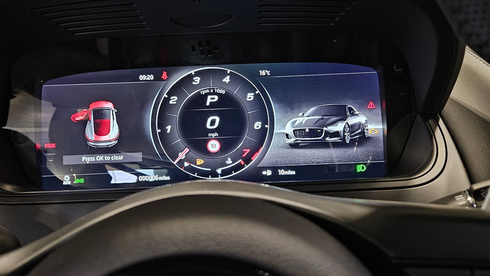

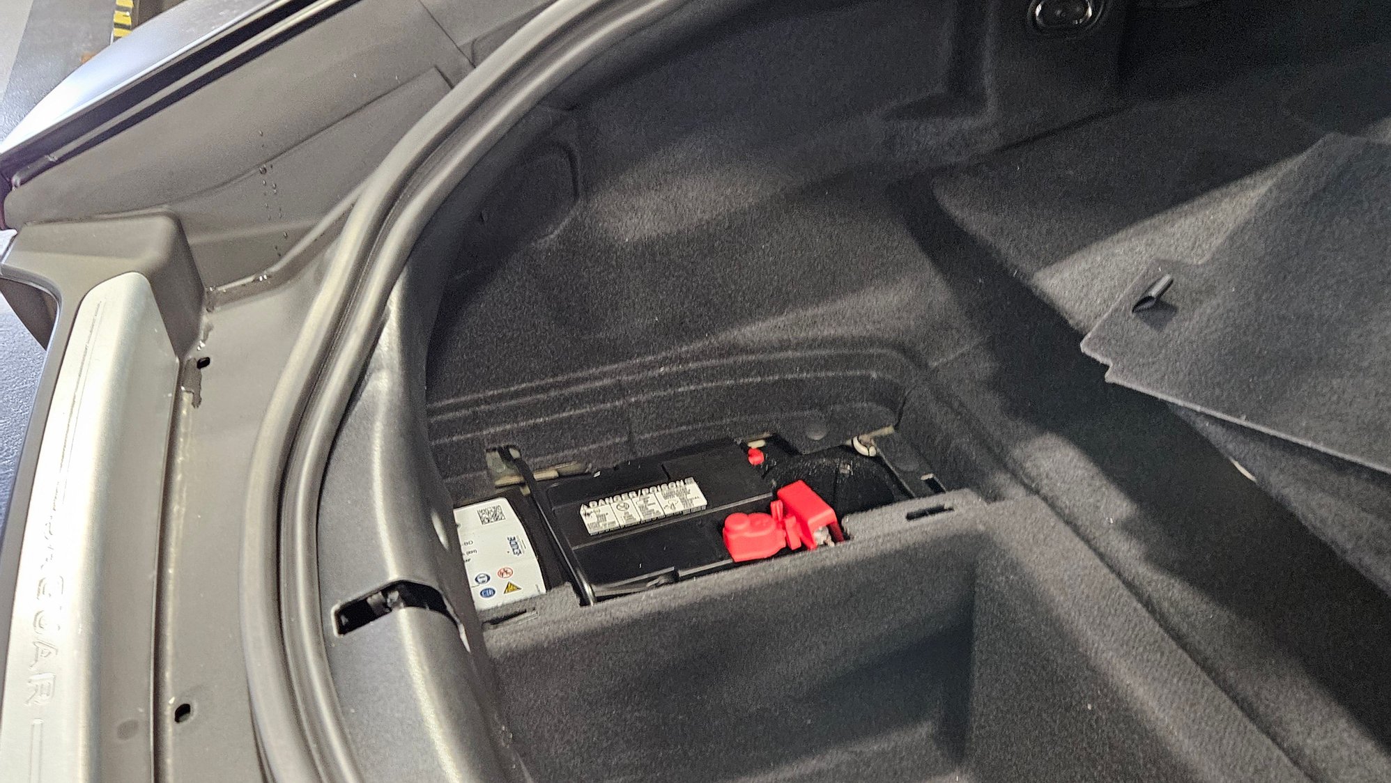

Back on track I hope...I have tested various wiring jumpers etc and non have faked out the BMS as it continues to cycle charge and drain my Lithium battery... Sooooooo my current solution is to un-plug the double wire plug at the battery neg. post location and the charging system shows a fault on the dash however it continues to charge at 13.5 volts keeping my battery full per my AntiGravity Battery Tracker. The charging system fault does not show on my Blue Driver Code reader so cannot be cleared and if it could I believe it would come back after each start up. Someday I'll get help from a electronics hobbyist on installing a diode in the system.
Thank you all for participating.....
