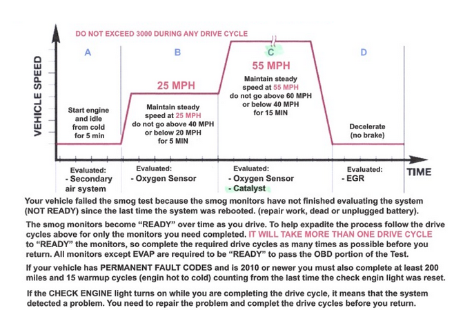

This is what you need to do get all the OBD parameters back to READY if you disconnect the battery.
Driving only 55 MPH for 15 whole minutes in an F-Type is difficult!
I drove gently for a few days, but at no time did I hold 55 for 15 minutes. That'd get you run off the highway here. Fortunately, a "reasonable" speed around here is still below 3K rpm.
