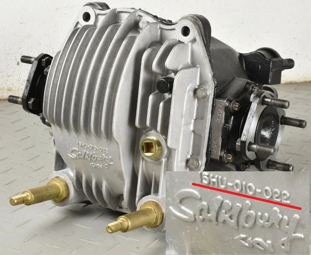

There is the thing on Diff output bearings getting dry from a plugged fill port vent screen , and can be repaired yourself with Diff stayon car
see bottom of list
JagRepair.com - Jaguar Repair Information Resource

The X308 and X100 use the 14HU with a different output shaft/stub axle arrangement with inline pinion/crownwheel but the idea is still the same.

If comes to this area
j 1998 - 2003 (from 812317 To F59525) (x308) Classic / Differential Assembly | Jaguar Land Rover Classic Parts
item X . Y . Z
Bearing kit offerings on E - bay but...................................

Keep the mind open and note your observations as I observed myself the diff output bearings on another X300 and can see how not easy to discern
There are also some TSBs listed under the same earlier X300 chassis that made tge list and missed the X308
See TSB on removing the output bearing retainer / collar if your issue comes to it
