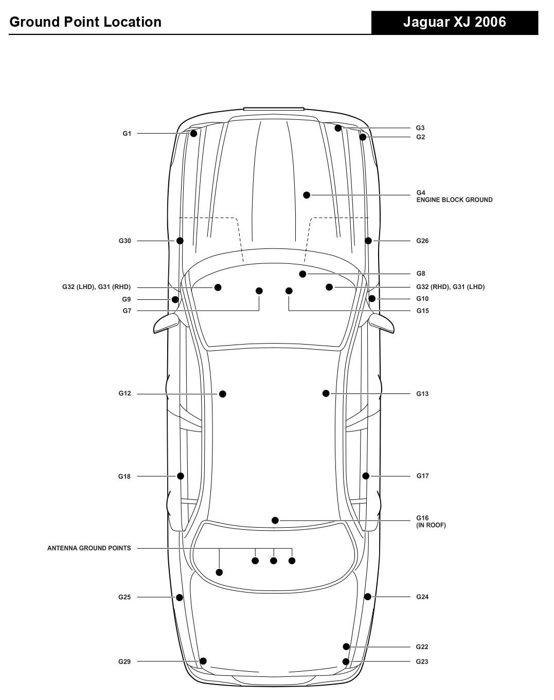

Good idea about the grounds. Have you had any of the grounding studs break off when you checked them? That's very common.
There are a lot of grounds too.
Any other symptoms? Wipers working OK? Another symptom of a bad ground is to turn on the headlights when you try to start the car. See if they dim.

Thank you for the diagram, I will look for more. All the studs were solid, the one under car I actually took bolt out and cleaned cable end/bolt/body with wire brush. That was really only corroded one I found so far. I did have the wiper swipe one time when the car was acting up but other than that all systems work fine.
