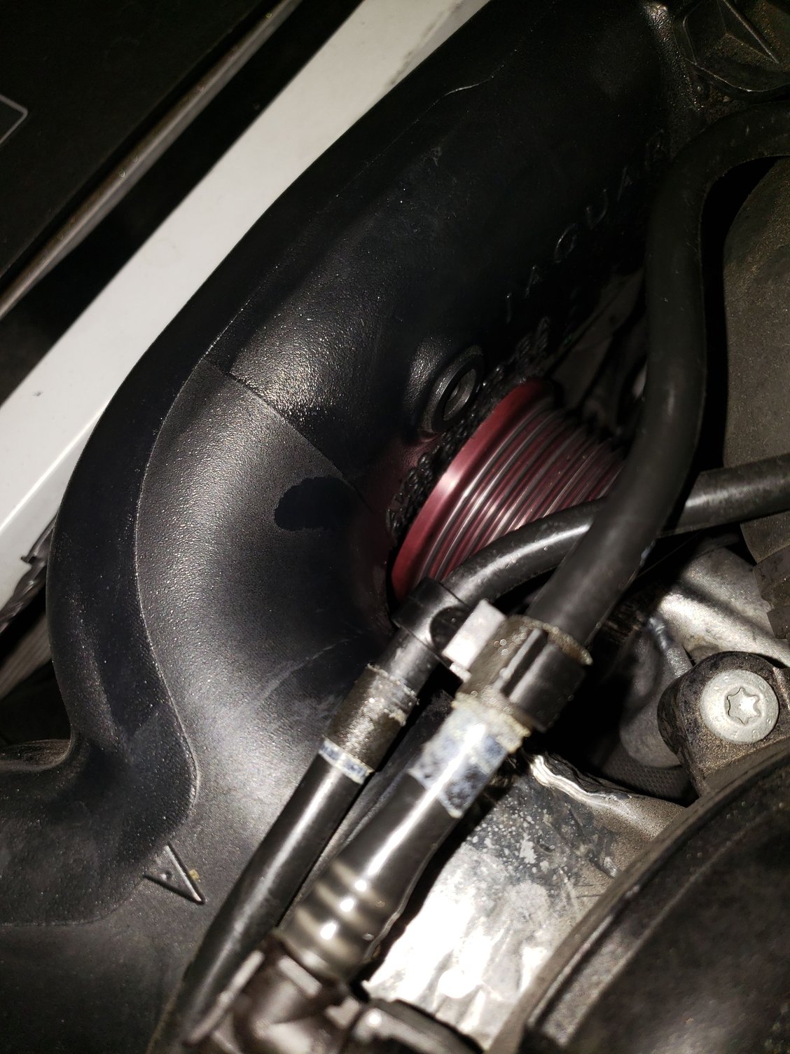

Here is a pic of the top pulley pushed into the intake piping. That has to be out of place and the snout has to be damaged correct?
I dont even know what to say to the dealer. I need to let them asses the damage. Eurocharged Boston installed my crank pulley but they're 3 hours away.

Perhaps just the bearing failed on the supercharger pulley due to too tight conditions from wrong lower pulley. I think VAP will help sort it out, but my thought is your grievance is with Vivid. The place that did the install just did as you asked based on what Vivid provided from VAP. I wouldn't have the dealer try to sort it out. They will charge you a gazillion dollars and want to put it back stock. Unless their cool, then just a gazillion dollars. It might not be that catastrophic.

I here ya.. I just have no one around whose willing to touch my car, other than the dealer. Unless I have the car shipped 3 hours to boston. Both pulleys will need to be done and possibly the snout. I'm really hoping velocity can get me on the right path here. Kinda makes me wish I had done the upper pulley and tune instead. I'm terrified of what this is gonna cost me either way.. idk which is the best path here.

I don't know of any f-type that has a red super charger pulley... are we sure that's not an aftermarket piece?
That's a good point. Maybe someone prior had put an aftermarket pulley on the supercharger? As a cool boy option rather than a performance mod? The added stress finally caused it to fail.
What's more concerning; I don't know of any aftermarket pulley that's red either. Which would lead me to believe its not from a reputable company like VAP, Eurocharged, etc. I'm sure that VAP will get you straightened out on the lower pulley set-up, but I question that upper pulley and wonder if that's the source of the failure.
