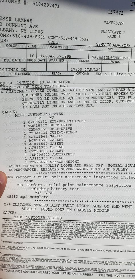

they covered it under warranty (shocked).. just got the car back two days ago. The trick is figuring out if they replaced the lower pulley because its not on the work order. Idk the right way to ask, without looking guilty.. one item is vague and just supercharger kit. I don't have the means to get under the car pull the trey off and check myself so I've have been taking it moderately easy on the car
The supercharger kit is nothing more than the snout assembly which includes the upper pulley.The lower pulley is not in this list of parts.
so then its gonna be in my best interest to get the oem pulley back on the oar because Idkhow bad that offset is.
then starts the problem of them covering warranty with that big black pulley on their and if something else goes wrong and the next time it comes in with a small gray pulley. Geez what a pickle 🤦‍♂️
It's almost like I'm trapped with it
