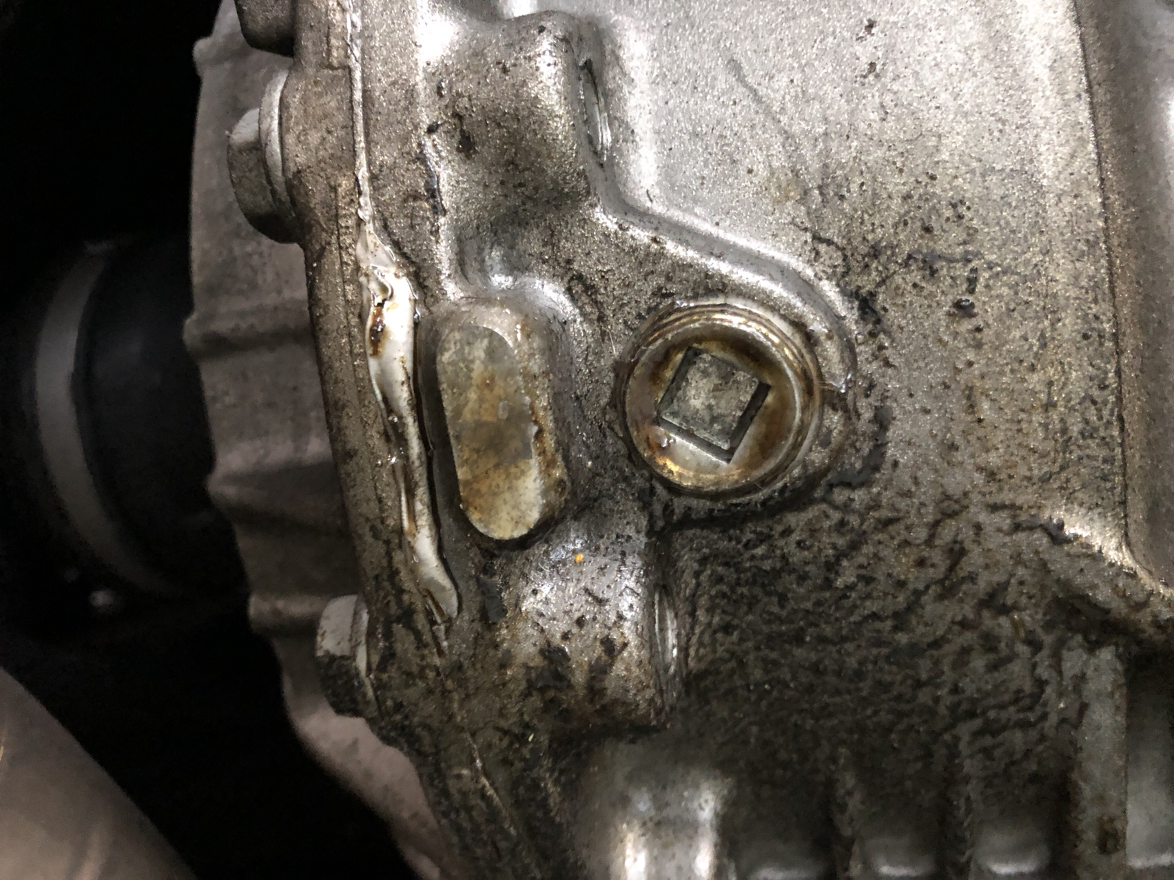

I know there are some other threads about rear differential leaks on this board. I had been noticing dark spots on my garage floor for months, but always dry. Convinced myself they were soot from the exhaust per conversion on those prior threads. Yesterday I happened to notice that the spot on the floor was still wet, and it definitely wasn't water. I'm not much of a gear head, but I'm pretty sure this is the differential, and I'm pretty sure it's leaking gear oil.
The round piece with the square inset there at the bottom is actually threaded on the outside. Is there supposed to be a cap on it? If not, what are the threads for?
Is there anything I could/should do to stem the leak and or refill this oil before getting it to the shop? They can't get me in for another week and it's my daily.

On further inspection, the seam to the left is the source. There's some kind of pliable caulk like material that I pushed on with a paper towel and squished out a good bit of oil.
That is the drain plug and those are typically threaded down the entire length, so some thread will always be exposed
If that’s where it’s leaking, you’ve lucked out.That will just require a gasket replacement. If it was leaking at any of the shafts, It would require a seal replacement necessitating removal of the differential from the car. Likely, the dealer would just replace the entire differential.

Originally Posted by Unhingd
That is the drain plug and those are typically threaded down the entire length, so some thread will always be exposedIf that’s where it’s leaking, you’ve lucked out.That will just require a gasket replacement. If it was leaking at any of the shafts, It would require a seal replacement necessitating removal of the differential from the car. Likely, the dealer would just replace the entire differential.
Thank you, Lance. That's some reassuring news. Ok to keep driving while waiting for my appointment? Or should I get a rental car?

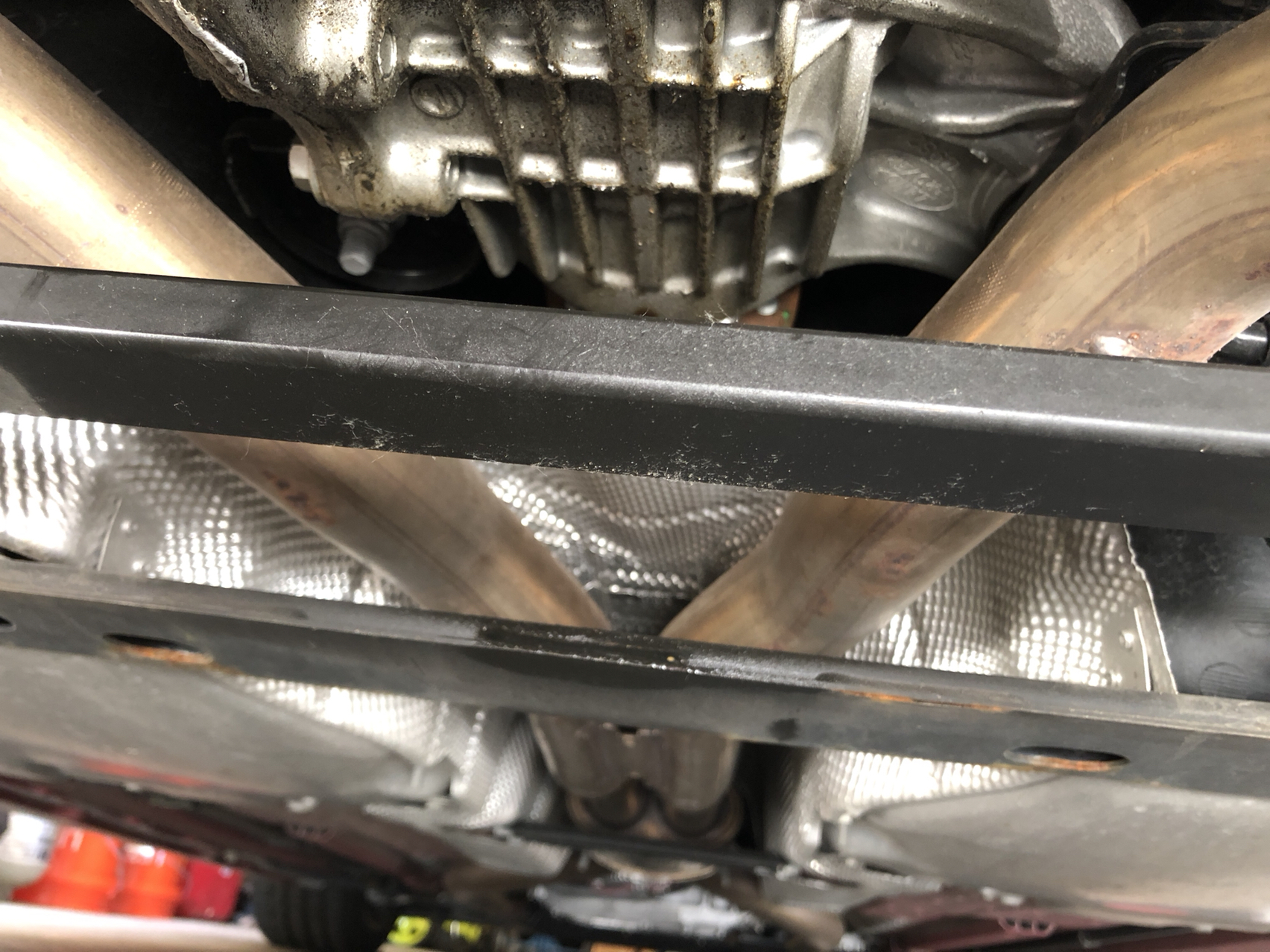

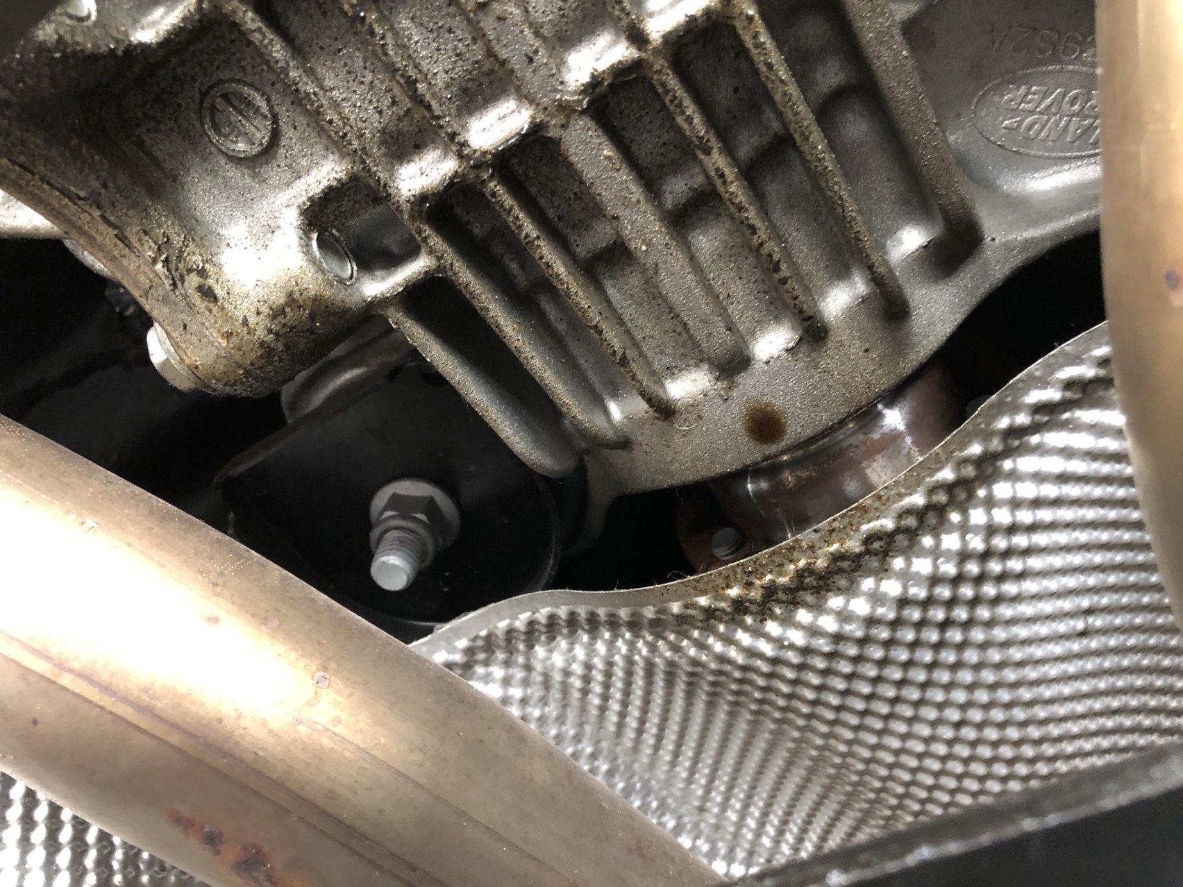

A couple more photos. There is more than one leak. The gasket as noted previously is definitely leaking, but so is a spot further toward the front of the car. I noticed a wet spot on that crossing support, and while I can't get a great view above it without a lift, it looks like the pinion seal is leaking as well.

Shop says it's the pinion seal only and not the gasket where the cover attaches. They topped off the gear oil for me and I'll bring it back when they have a loaner available for the seal replacement. I'm still of the opinion that there are two leaks. I guess we will see. At this point, no new differential for me.

So my leak was in front of the diff at the pinion seal. Oil was essentially dispersing up over the top of the diff when the car was in motion, then settling down by gravity along the gasket seal when parked. I thought for sure the gasket was also leaking. They replaced the pinion seal and I've been parking over a clean cardboard box. No more drips.
