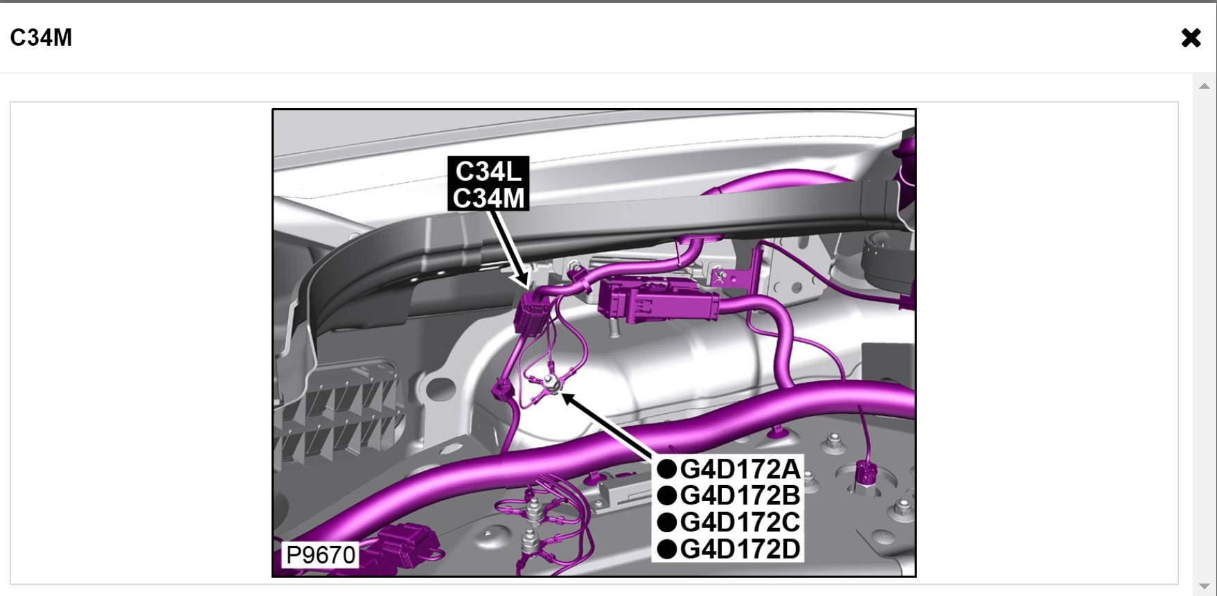

A friend sent me the diagram for disconnect of the spoiler via the trunk for a 2015 F type R.. hopefully the attachment comes through.
Some members have asked me for this info.
Lawrence

Can you offer some clarity here. Where in the trunk is the attached graphic showing?
Just disconnect the C34L / C34M connector?
of does something also need to be done with what looks like a grounding screw?
I didn't do the work, the guy that supplied the diagram did and as far as I know it was the left side of the trunk.

C34L / C34M are to the left of the battery, as far as I can tell from the diagram. Can't tell if those are related to the spoiler - I'm just noting the location.

Was it ever confirmed if unplugging the connector (C34L/M) in this diagram works to disable the rear spoiler with no warning lights or issues?
Yes, it works perfectly, I did it 10 months ago and not a single issue since, see here: https://www.jaguarforums.com/forum/f...7/#post1614196

Thanks Oz, but I am a bit confused after reading your thread on how to disable the spoiler.
The OP in this thread seems to indicate that all you have to do is disconnect the plug shown in the diagram which appears to be on the left side of the trunk / wheel well area and not under the spoiler, in the motor mechanism itself. I am wondering if anyone else can confirm if this works?
Yes, I know I could try it myself, but my car is currently in storage for the winter and I am considering an aftermarket spoiler.
The plug you need to disconnect is under the spoiler, I think it is the same plug as shown in the illustrations above (in which case they are a bit misleading as to exactly where it is and how you access it), and you need to follow my how-to.
