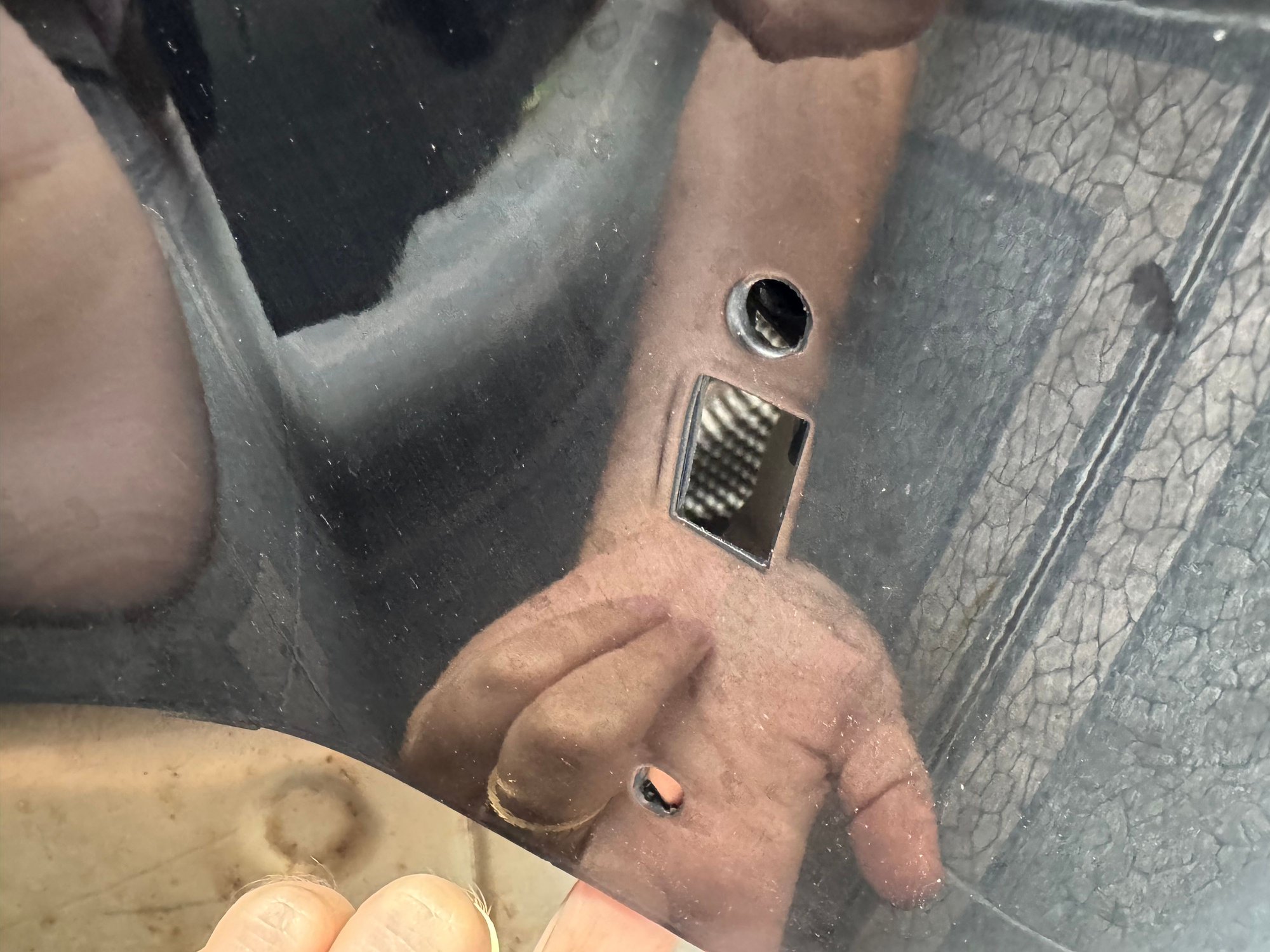

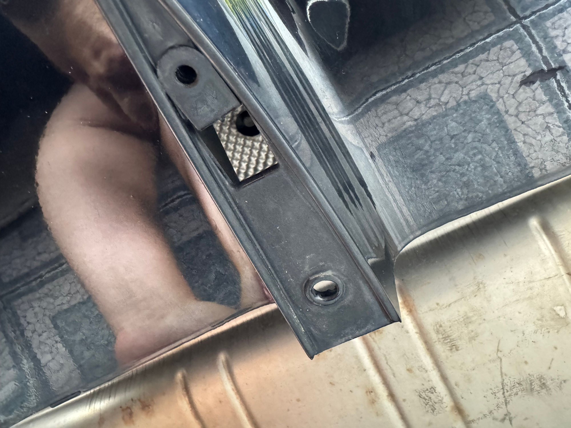

Guys, any of you have access to their SVR or R with later SVR style diffuser and would be willing to help?
When I got my 2016 R it already came with SVR wider lower diffuser installed by previous owner but it lacked the lower cross bar (I see a lot sold like that somehow). So I only had 1 fin going down there right in the middle (let’s say half P7 style haha).
Due to the fact that lower cross bar is one part number with the lower diffuser section I could not really obtain the bar alone via dealership without paying top dollar for the whole unit while actually already having like 80% of it on the car.
Luckily now I got it from someone who replaced his bar with a carbon one.
Thing is, I got it without screws and I wonder what screws/nuts/washers/pins I need to put it on the car.
Looking at some SVR underside pics online it is just a bunch of regular torx screws there, do I just use some washers and nuts on the other side or is there anything special in there?
and here is what I see on my car:
