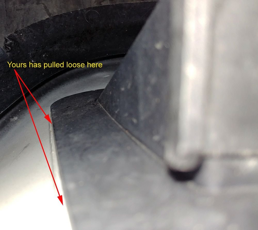

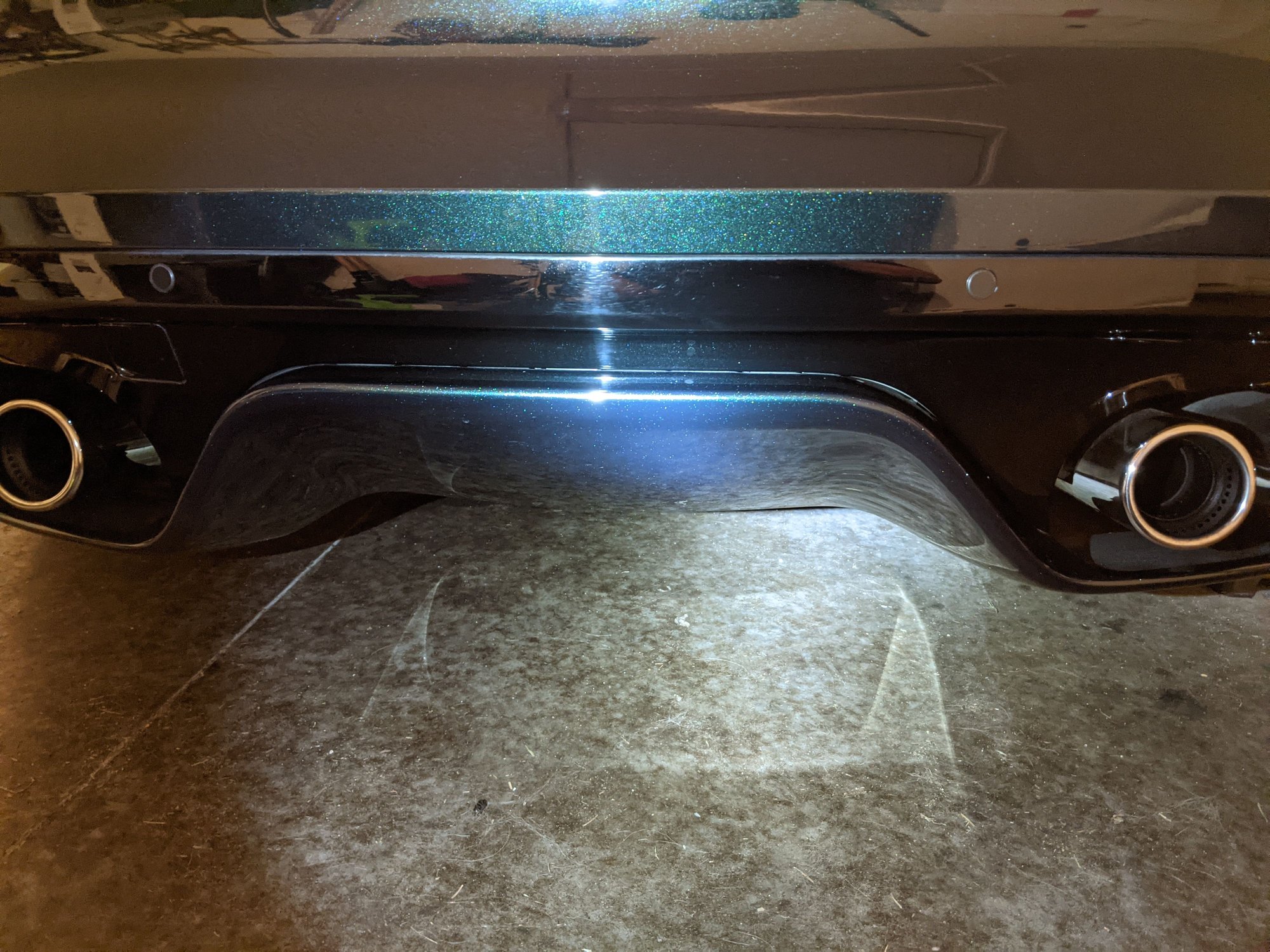

Sorry guys, photos really do help. So I noticed when washing the lower valence that when I push on this part of the body-colored panel between the two dual exhaust tips it flexes a lot, and felt that it would be catching air at speed and wouldn't be good.
Underneath, there's two of these brackets shown below, about a foot or so spaced out from eachother. Now that I went under there with a flashlight so I could actually see well, it certainly appears like they are supposed to be attached somehow...like that pad is some sort of adhesive or something.

Yes. It appears that the adhesive has failed on the mounting points (where the bracket should attach back to the body). You can clearly see the gap and the hole where it was mounted against the car. Either take it to a dealer if you have a warranty or a collision center, or if you are the least bit handy with working on cars, I would just clean the surfaces very well, scuff them up (the mounting points), and wipe with degreaser or alcohol, and apply some two-part epoxy, and you should be good. If possible, I would detach the bracket first so it is not pulling on it while it cures. Many newer epoxies set up pretty hard in about 5 minutes, and totally cure in a few hours to 24 hours.
Good luck.
DC
See below:

Thanks DC, appreciate the photo. I do still have a short bit of time left on the warranty, so I'll have to make an appointment soon.

Looks like it was a pre-cut piece of foam with adhesive on both sides. If it's available separately, that might be better than an epoxy. If there is indication that something caught the diffuser and pulled it free, it might not get covered under warranty (physical damage).
