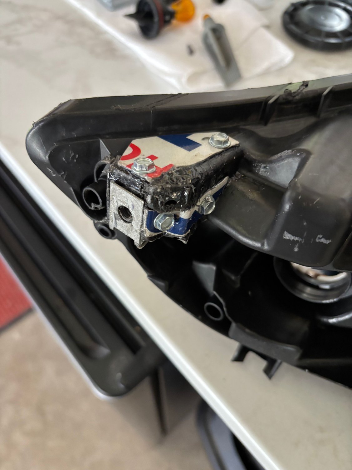

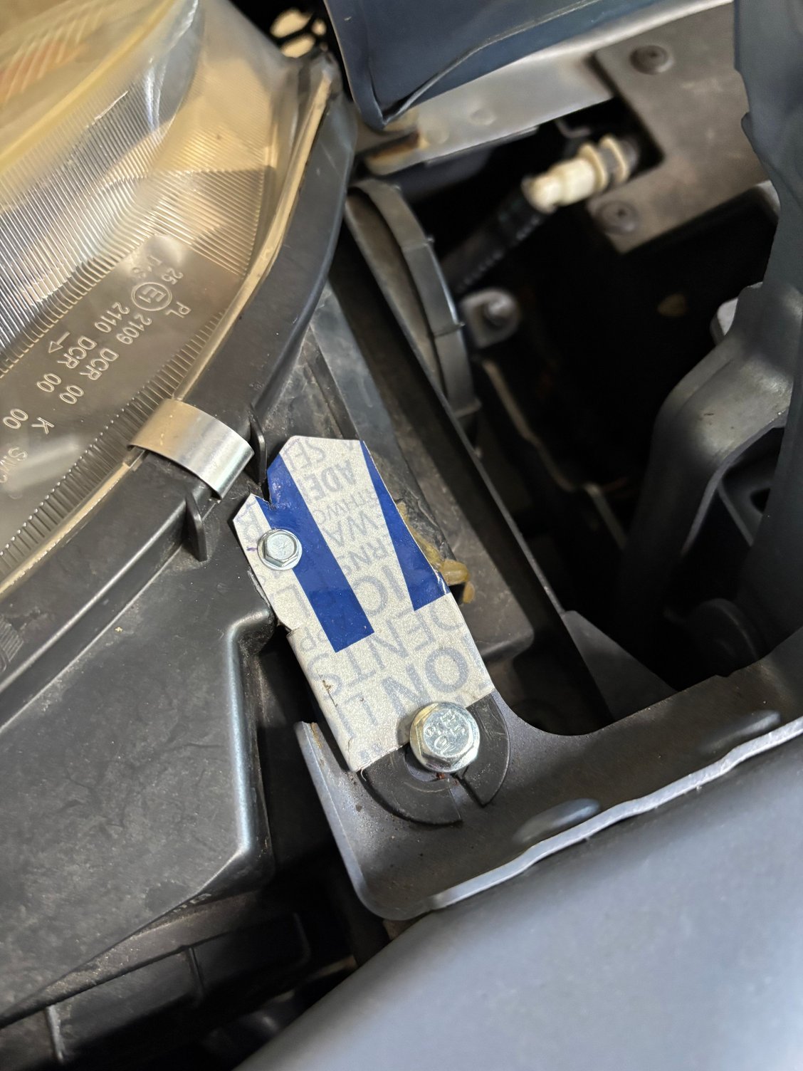

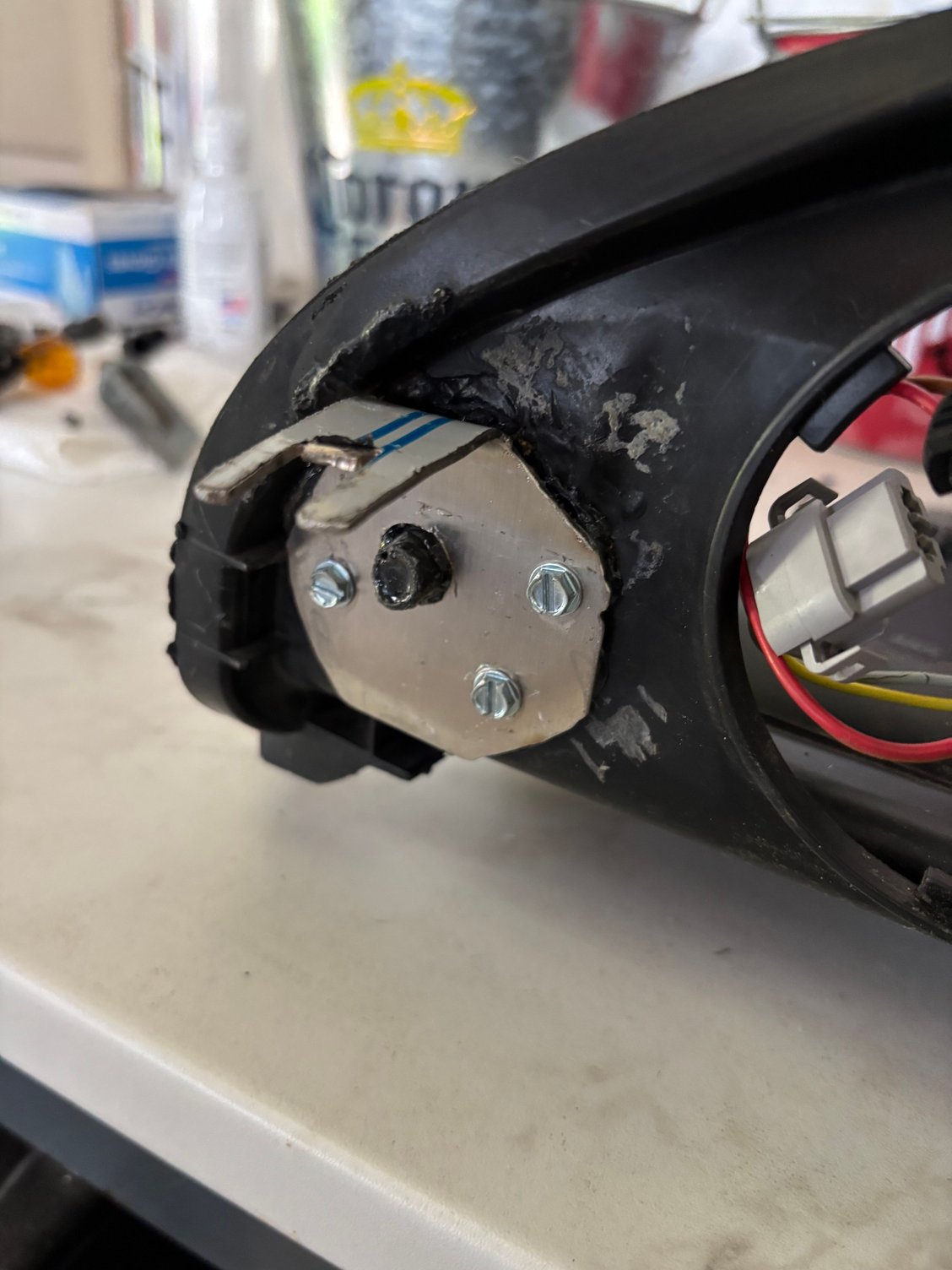

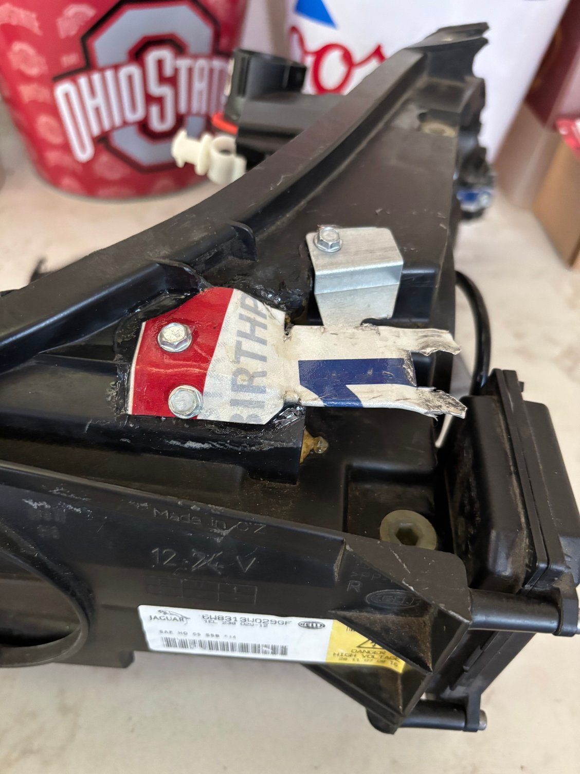

Default Fabricated tabs
Three of the pics are from the dismantled old headlamp. The last is the other headlamp installed in the car. I can answer questions if anyone cares to even attempt this messed up looking monstrosity. It did work though.
Not license plate. This is thin aluminum.
Silver piece at top was used to make adjustments by bending it up or down.

That actually lines up ok like that? I'm impressed.
yeh, one little tap and they break!
