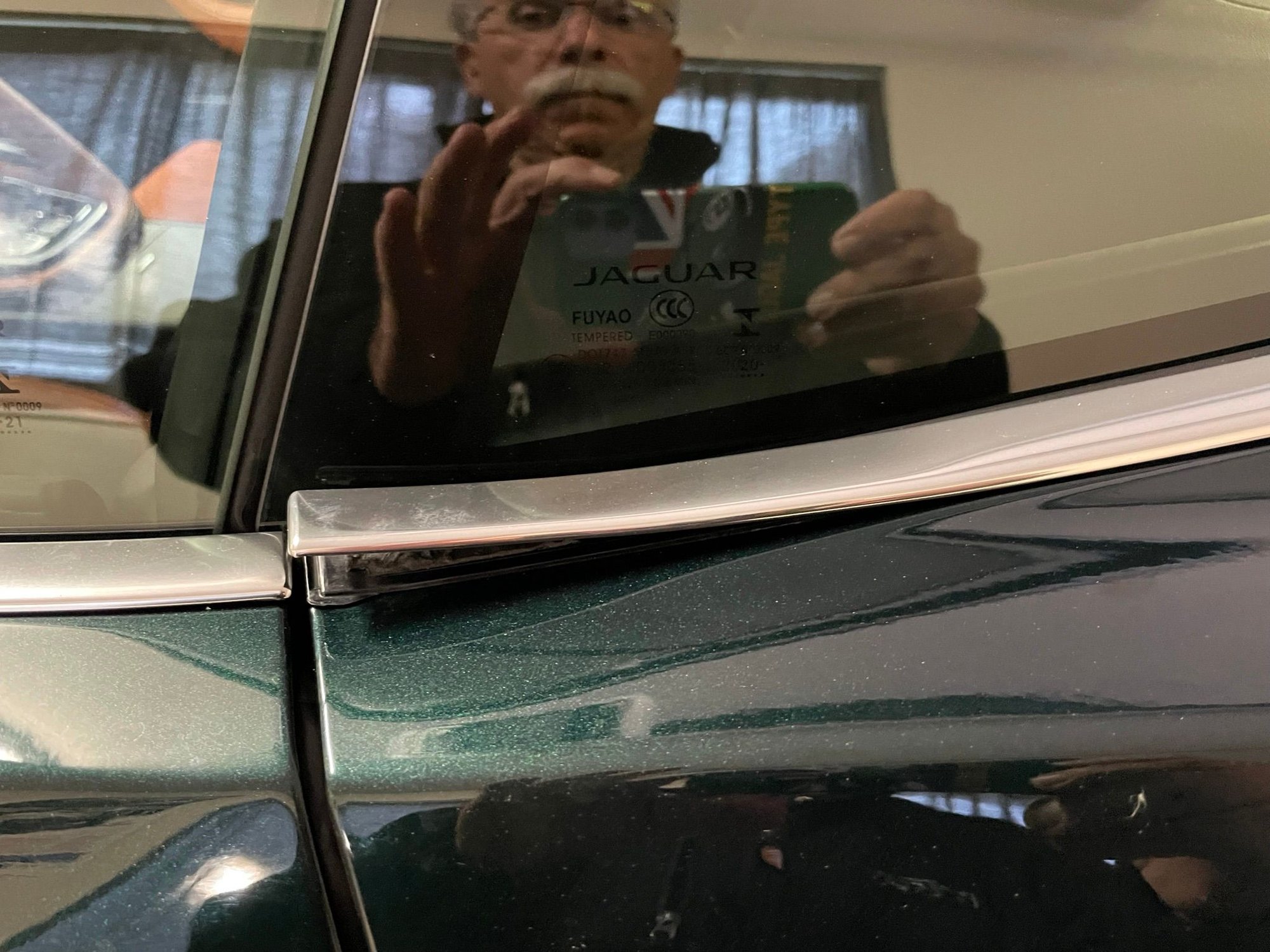

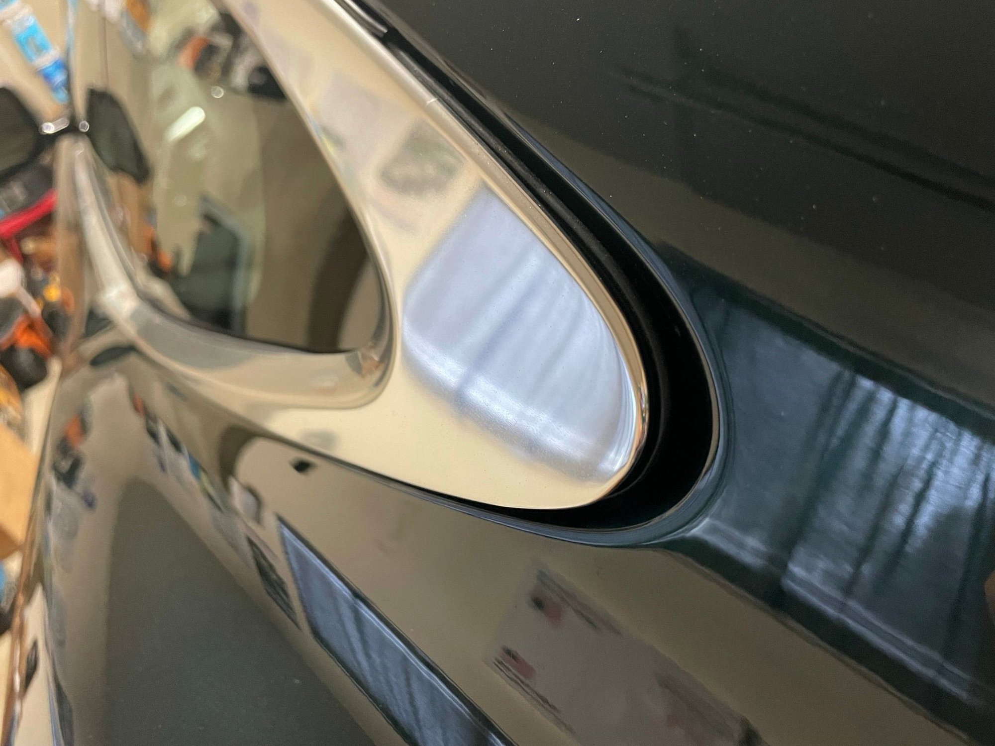

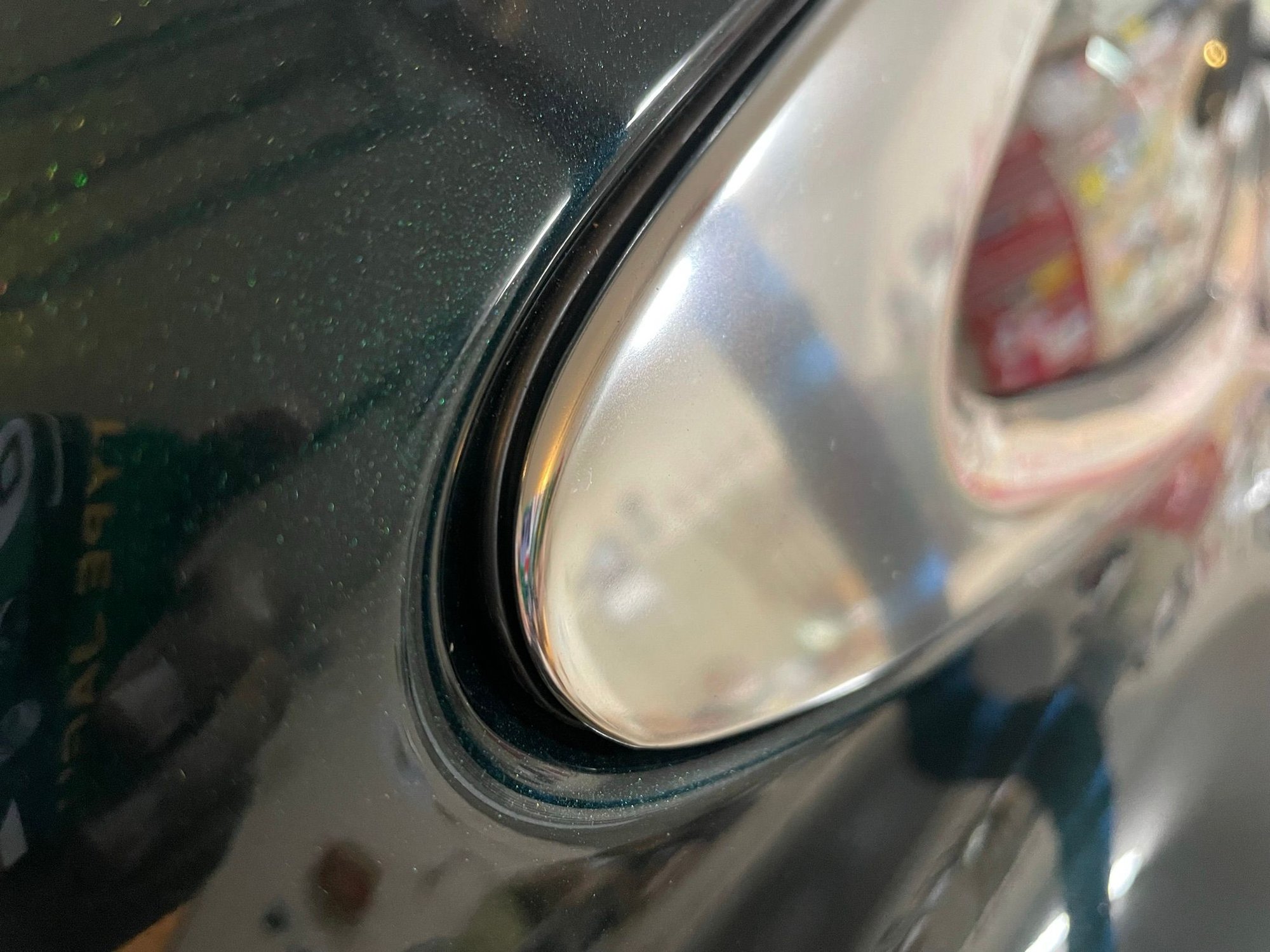

the rear window trim on my 2022 F-Type coupe has issues (see pictures). the drivers side trim will be replaced by my own body shop, the dealer gave me the parts and will cover repair under warranty. Has anyone had this issue on their F-Type, I saw an older one recently that had the same issue.
The other problem I am having is a clicking sound on acceleration, I believe its coming from the left side. I have a dealer appointment this coming week to check it out ( for the second time).
drivers side trim
Passenger side trim
have no idea how this happened

Reviving this old thread about this known issue... how much of a gap is normal or acceptable, in terms of not causing leaks etc, for the rear window trim?
I have a gap/flex of about 2 mm at the rear of the trim on the passenger side of the car while it's much tighter, flexes just a little bit like 0,5 mm on the driver's side. The ~2 mm gap of on the passenger side shown below is not really visible and doesn't bother me and I'm just trying to figure out if it's worth to tell the dealer to fix it under warranty.

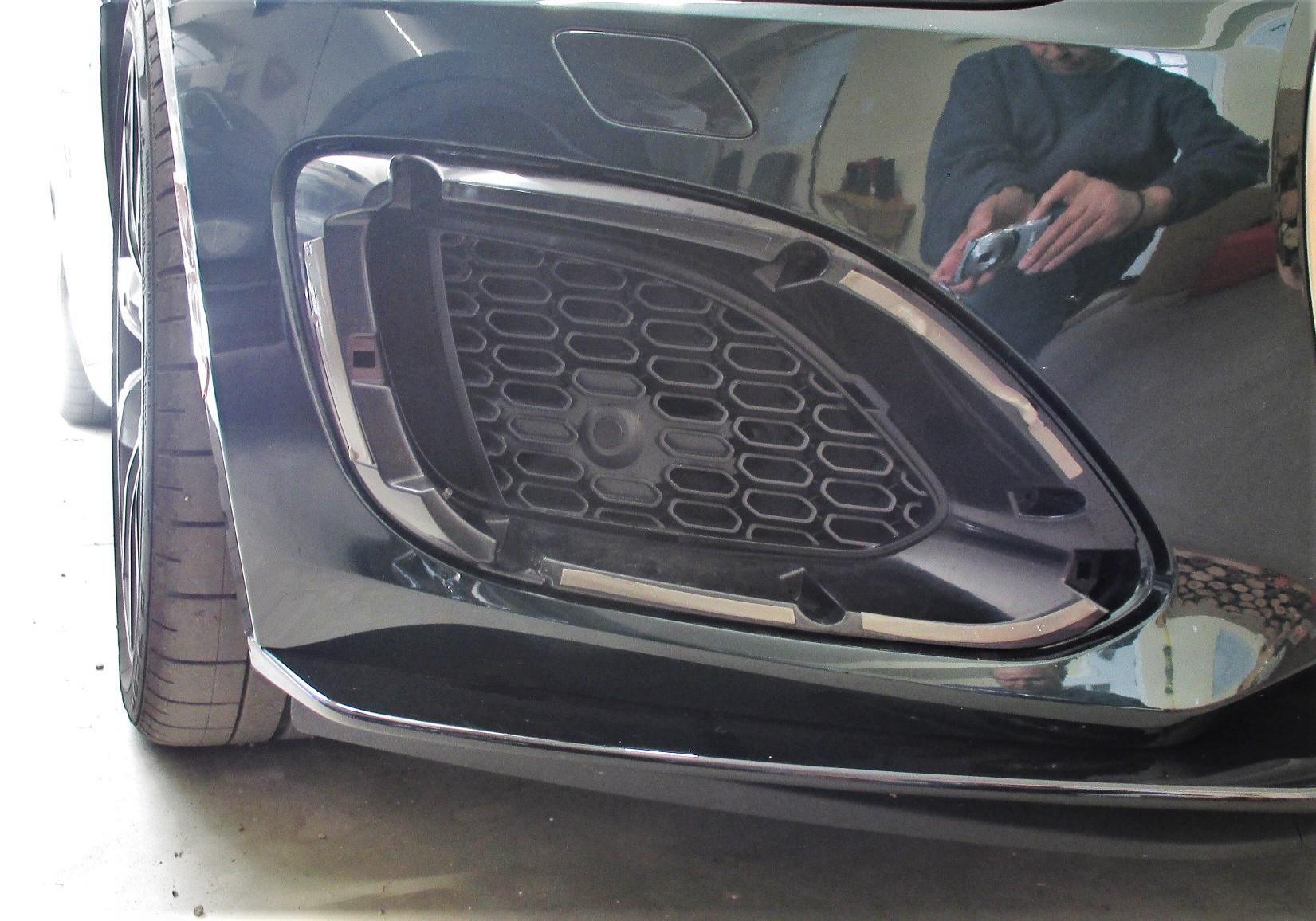

JLR must be having problems with their supplier of double sided tape. I posted a message on this forum a few days ago about the missing trim/bezel on the right side air intake on my 2021 F Type. It must have come loose and been ripped off by the force of the air rushing over the front of the car at high speed. There is nothing left except the remnants of the tape strips. It looks like the piece was also attached with a couple of snap-in tabs but they must have sheared off when the piece tore loose.
Luckily my dealer is ordering the part for me as a warranty claim, otherwise I would be out over $221 for the part. It's probably a good idea to check all body trim parts for proper attachments each time you wash your car and catch any problems before they get worse.

I took a closer look at the air intake on my F Type yesterday. I was able to peel the remaining double sided tape off with very little effort. You can see that the piece of tape at the 12 o'clock position is missing so it must have been stuck to the trim bezel when it came off of the car.
I'm wondering if the factory used a poor batch of the tape, or simply neglected to install it properly. I installed splash guards on my Mazda CX 5 a couple of years ago. The instructions were to clean both the plastic parts and the metal body attachment points with a solvent like denatured alcohol or Naptha, and also to use the 3M brand primer on the bonding surfaces prior to attaching the tape. The splash guards are only secured with one screw and the tape but they are rock solid after almost 3 years.
While I am waiting for my dealer to send the replacement bezel I am going to purchase some of the 3M tape that is made specifically for mounting automotive trim pieces and their primer.
