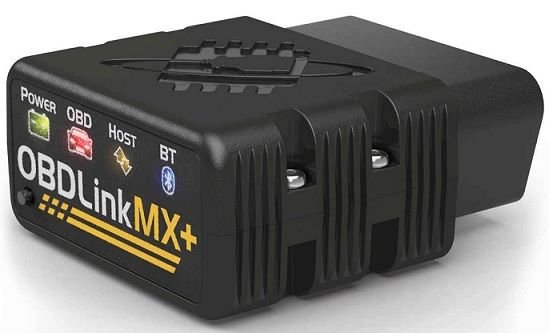

I use this one and keep it in the car. I like the fact it powers down automatically too. I was leaving it in all the time but after reading problems here on the F-Type forum I no longer do that.
Now it is more expensive at $140 but it's the best one I have found and I have at least 10-12 different ones I have picked up over the years.
OBDLink MX+
