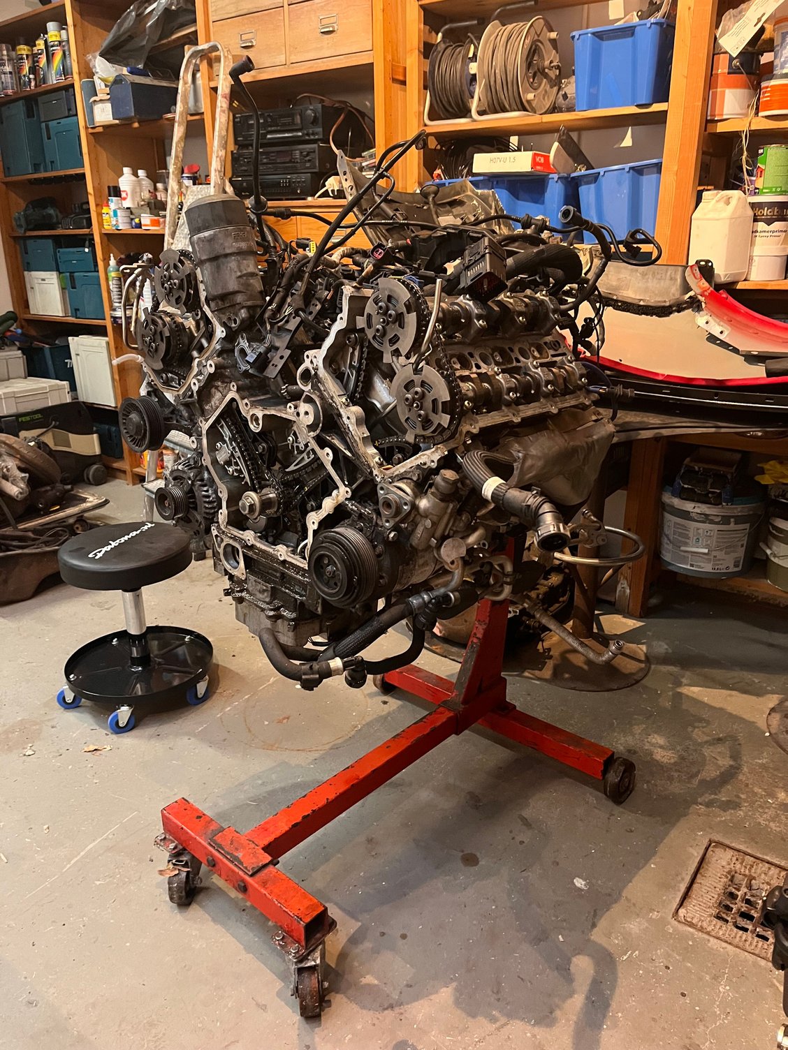

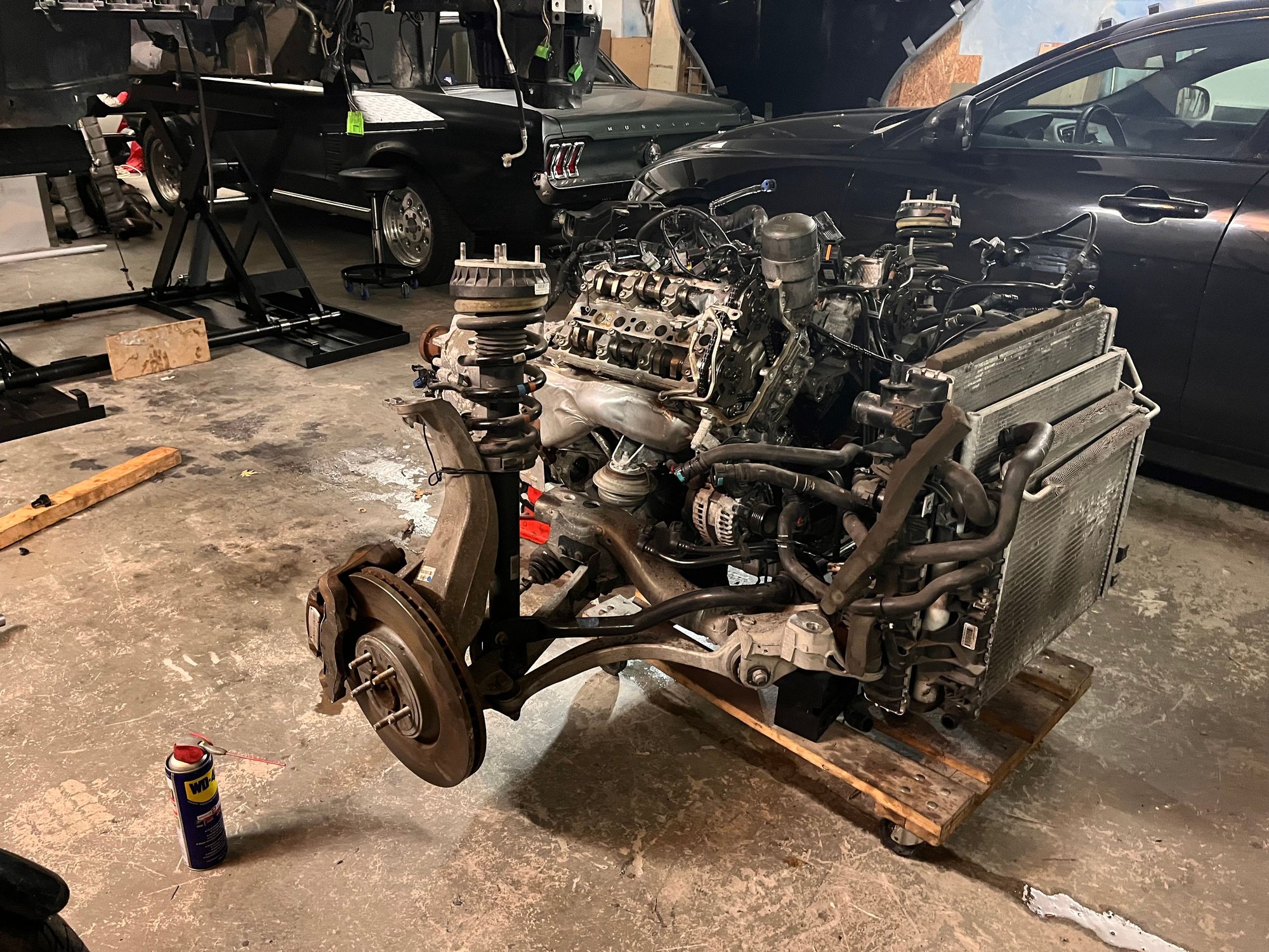

Default It’s out….
That worked. No way It was going from the top. To many hurdles.
Just out of the car, still in it’s subframe
Engine in the workshop
