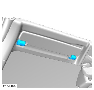

Can anyone explain how to remove the sun visor...clips? The plastic clips the sun visor attach to/
Thanks
Mitch

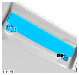

The workshop manual isn’t that helpful. It looks like there’s a cover on each hinge that snaps or slides off, then 2 screws can be removed…
Torque: 6Nm

My sun visor doesn't have any screws in those areas.

I did it just over eight years ago now, so as to remove the idiotic airbag warning stickers, see here: https://www.jaguarforums.com/forum/f...6/#post1670869
Put simply the plastic cover pushes/levers off with a pry tool then underneath the cover you have two Torx T20 mounting bolts, remove those bolts then wiggle the visor out.
