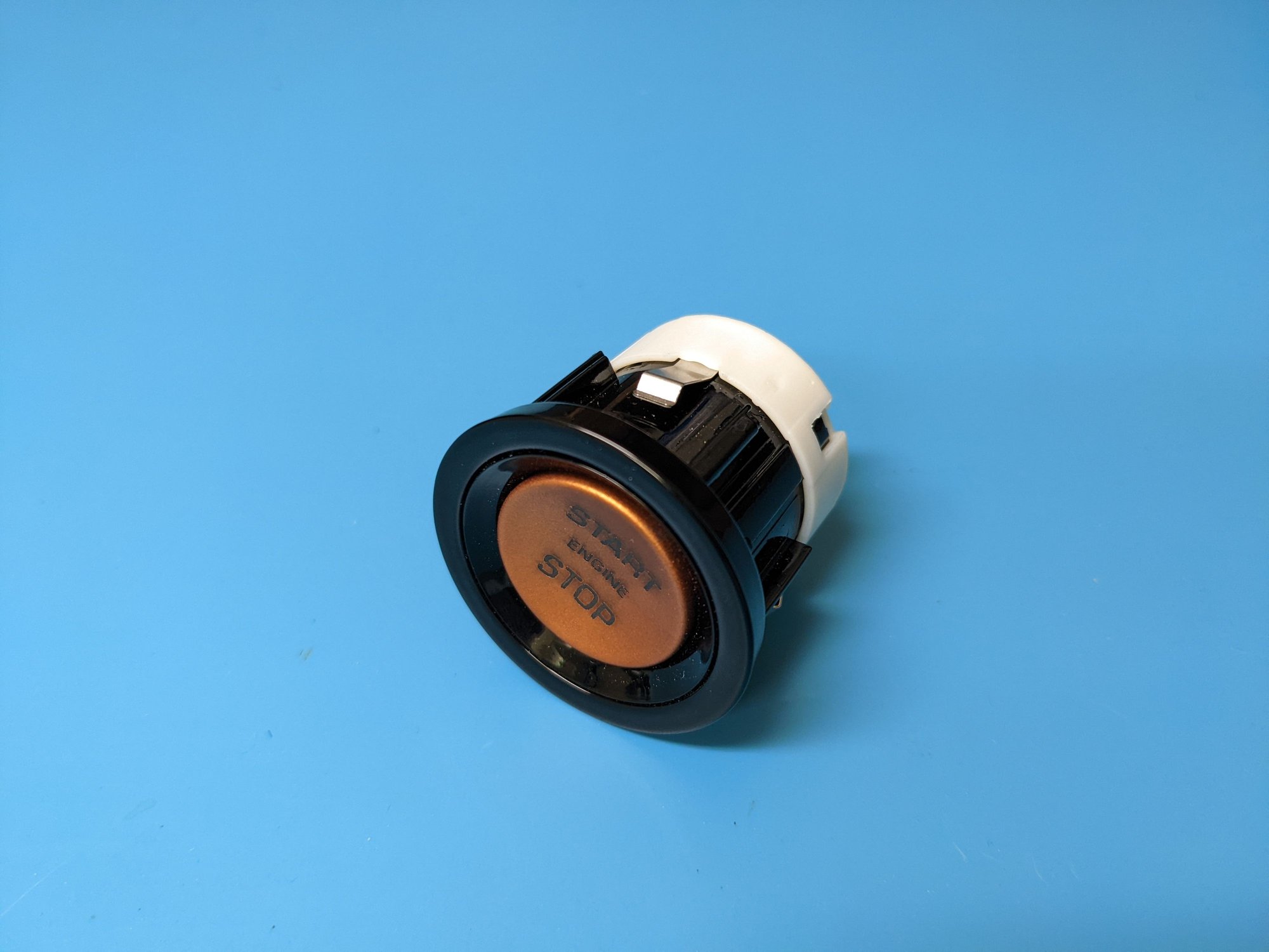

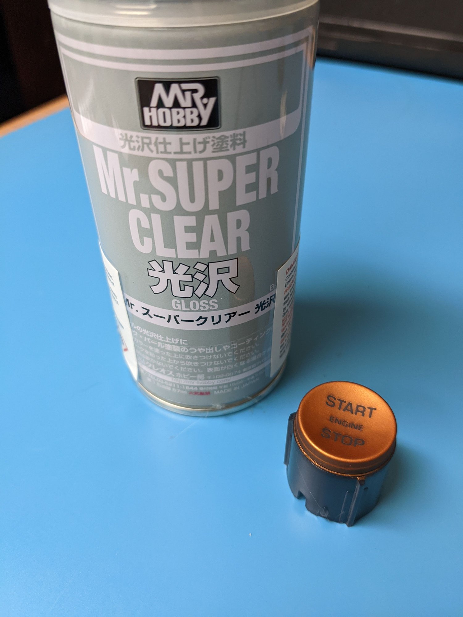

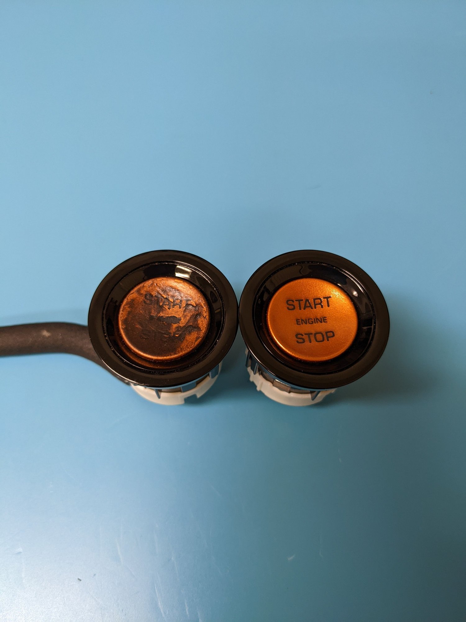

Old Aug 16, 2023 | 03:11 PM
DanoldKong's Avatar
Joined: Jun 2017
Posts: 26
From: United States
I wanted to share some photos of the torn down button, and the clear coat/sealant I used on the orange bit.
The button is really simple inside, just an LED and switch essentially. Not much for the $80 it cost, haha.
It looks good, I can only hope that it lasts. Might try replacing the orange gearshift paddles in the same manner if it holds up.
