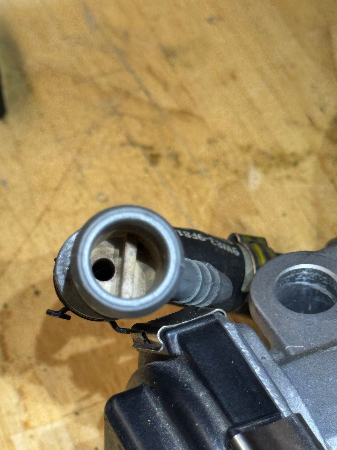

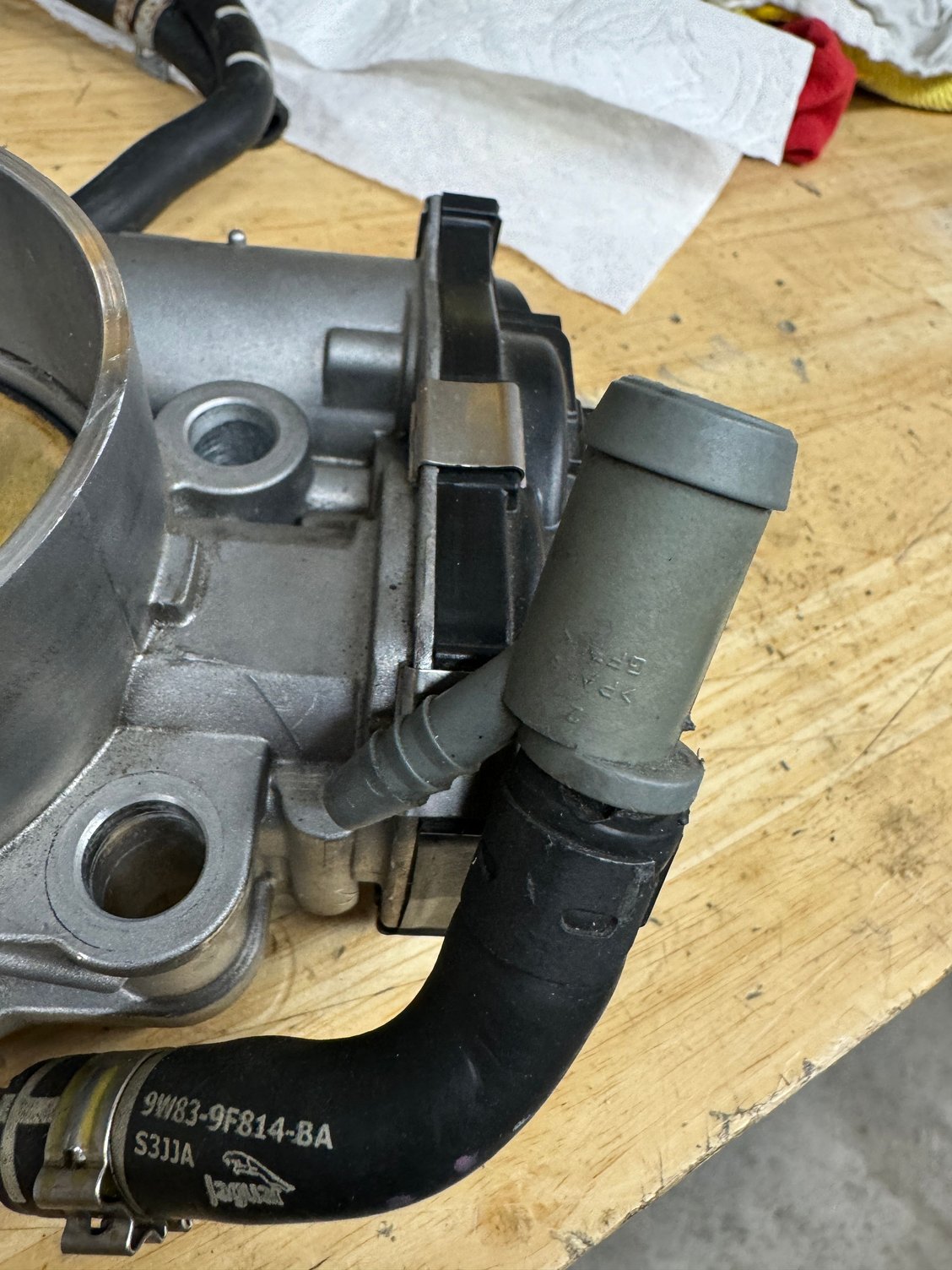

I just replaced the Y pipe on my 2018 F-Type with the V6S. After reinstalling the supercharger and intake, I noticed a bare hose barb with nothing connected to it. Is this correct? Should anything be connected to it? The hose barb is a tan color.
Thanks!

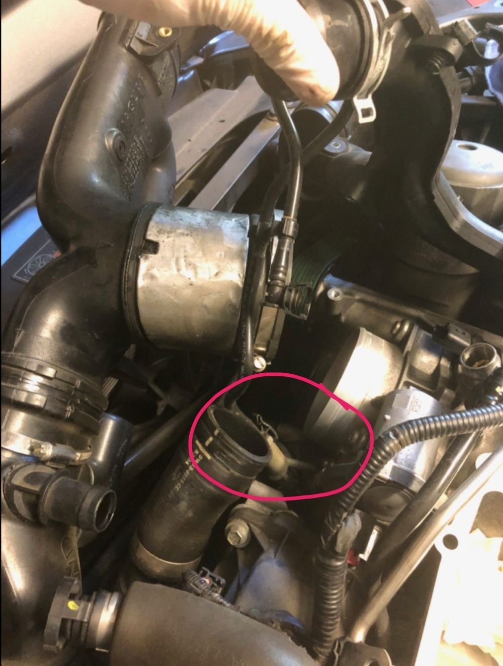

That's the adapter for the coolant to the throttle body. It's a multipurpose fitting that can be drilled out to attached a third connection. On the F-Type, there's nothing that connects to that port. See pic, below. You're setup is as it should be.

Phew, thank you for the confirmation! I thought I left a hose underneath the supercharger and have to remove everything again!
