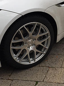

I used to own the 2016 F-type base model. I purchased aftermarket 19" Braelin rims for my winter setup. The rims have a staggered setup (like the stock) with +45offset in the front and +25 in the rear.
I have since upgraded to the 2018 F-type R-Dynamic with the upgraded red caliper brakes - 380mm front AND 376mm rear.
Just not sure if the 19" winter rims will clear the brakes on the R-Dynamic. For your viewing pleasure, I also had the winter rims powder coated from the original silver (see before and after pics).

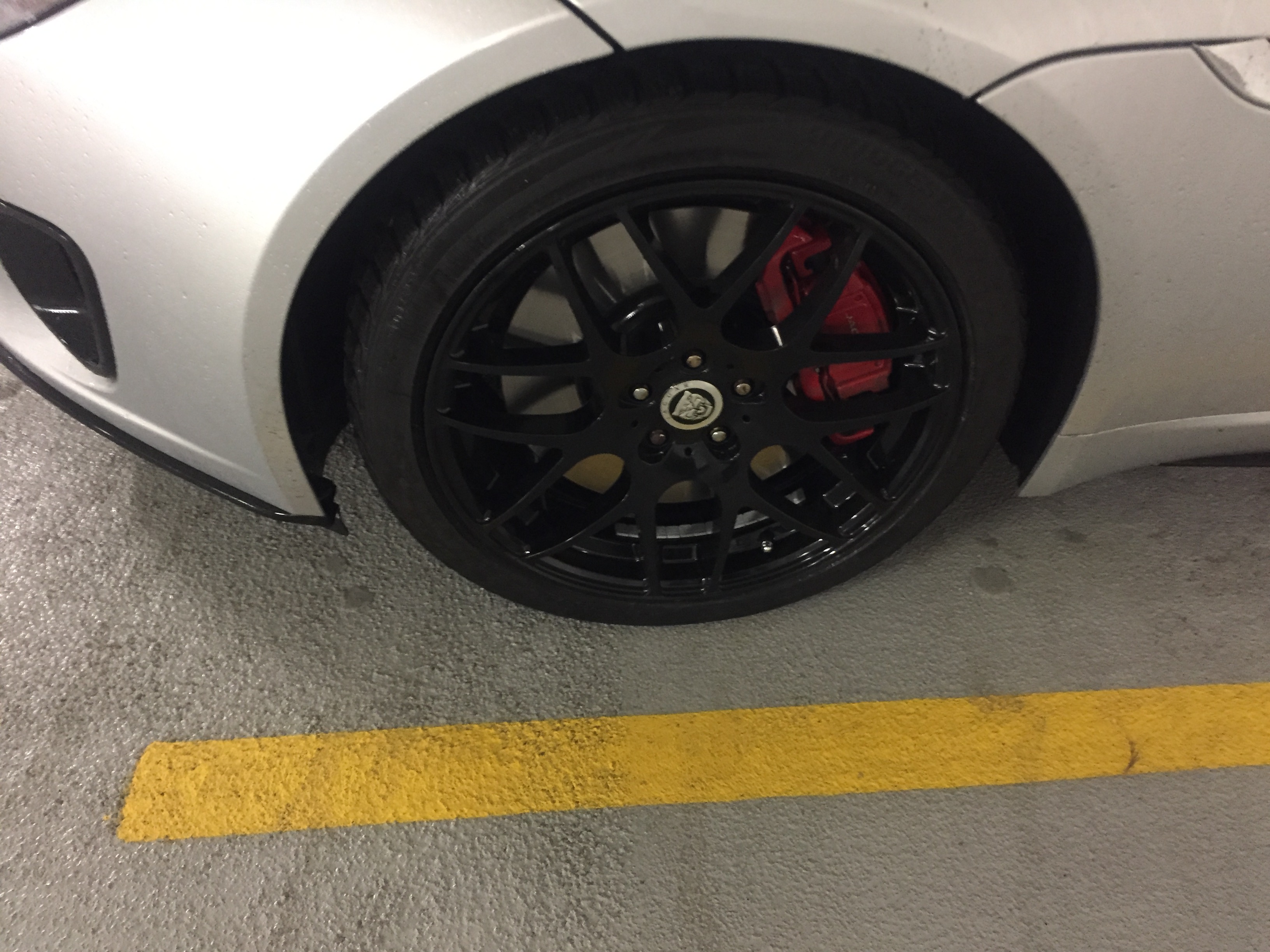

Ok -- problem solved.
Thanks OzXFR -- it seemed to be the weights that were only slightly getting in the way. Turns out my guy had a smaller profile weight he was able to swap the existing weights with -- done deal.
Pics of the the rims are attached. These are Braelin BR06s that were originally silver but have since been powder coated to black (long story, but when I bought these they were out of the black -- but the silver was horrendous in the winter...). I found some Jaguar decal weatherproof stickers to slap over the Braelin silver wheel caps. Voila!
