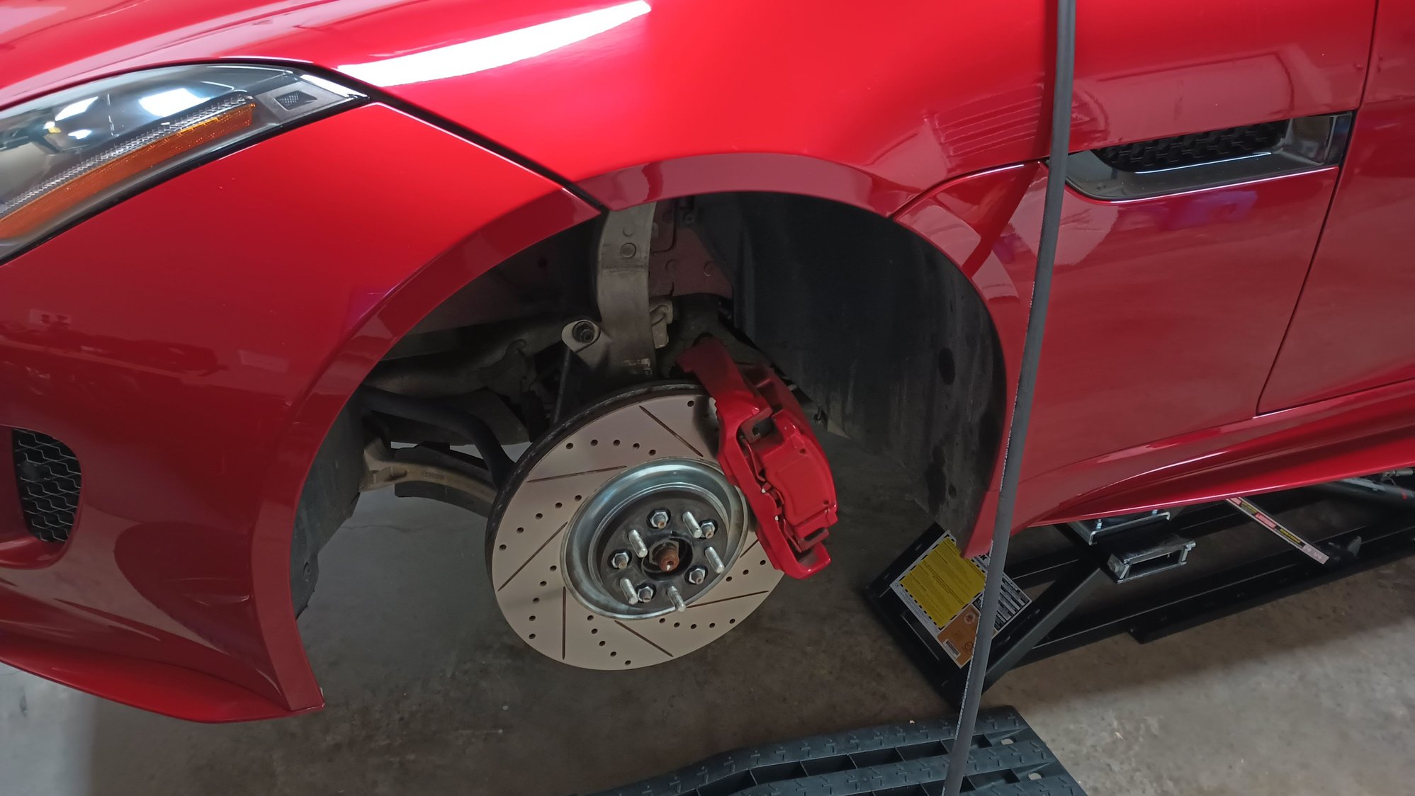

I run R1 Concepts eLINE slotted and drilled rotors and Porterfield R4-S pads. I don't track the car, however I do road race it and am quite happy with the setup.
