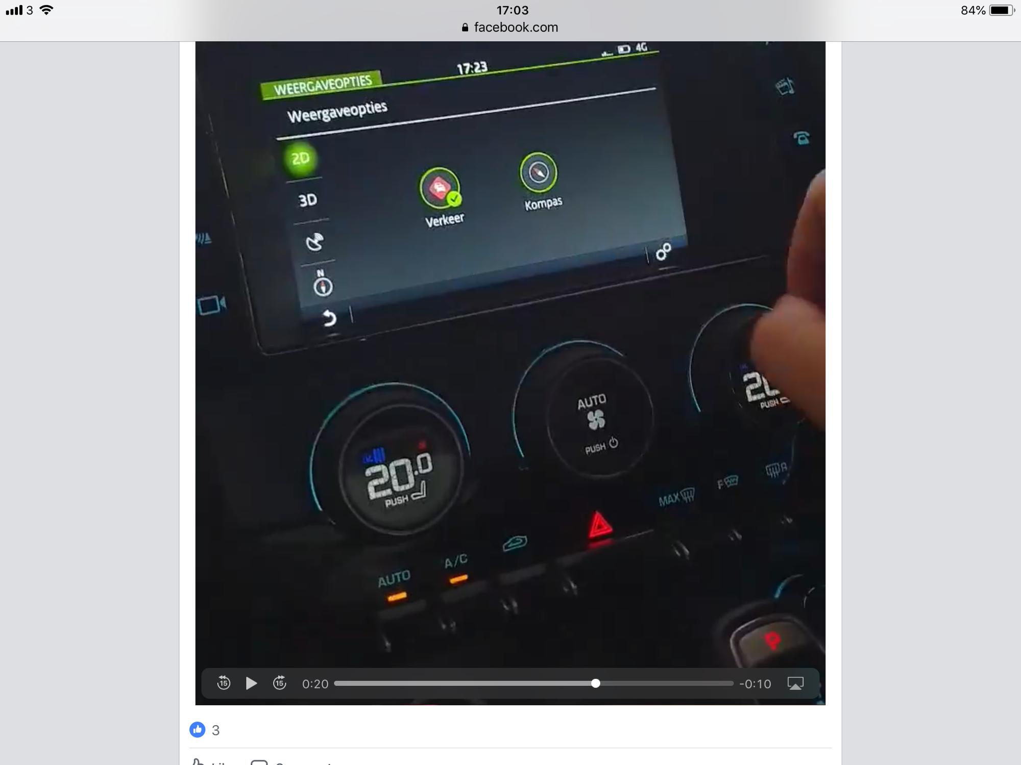

Guy on fb posted this. Says he has a SIM card and dealer enabled google maps. No further info.

He has now posted a video on fb. It seems that the dealer has replaced the Jaguar map with google maps. On the touch screen he just touches the map option, bottom right, and google maps appear.
It’s a closed group but here’s the link to try
https://m.facebook.com/comment/replies/?ctoken=1813847055363332_1814587368622634&count=6& curr&pc=1&ft_ent_identifier=1813847055363332&gfid= AQD_n18r3T3VHBOU
He's just posted that he can also choose the Jag map. No idea how this was done but it seems to be connected to the fact that he has a SIM card slot under the armrest.

He has now posted a video on fb. It seems that the dealer has replaced the Jaguar map with google maps. On the touch screen he just touches the map option, bottom right, and google maps appear. It’s the latest screen with no buttons.
Its no more then what you do on 'google maps' on your PC. You choose map-view or sat-view. But the last one eats tonnes of data. Beter warn him to set the MAX DATA USE in the connections menu,
to avoid nasty [costly] surprises at the end ot the month..
