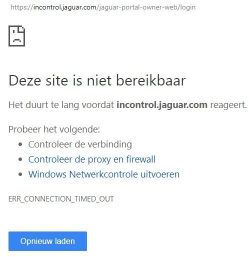

Hi Bill,
Don't know what you did to the mainframe, but its a flatliner...
