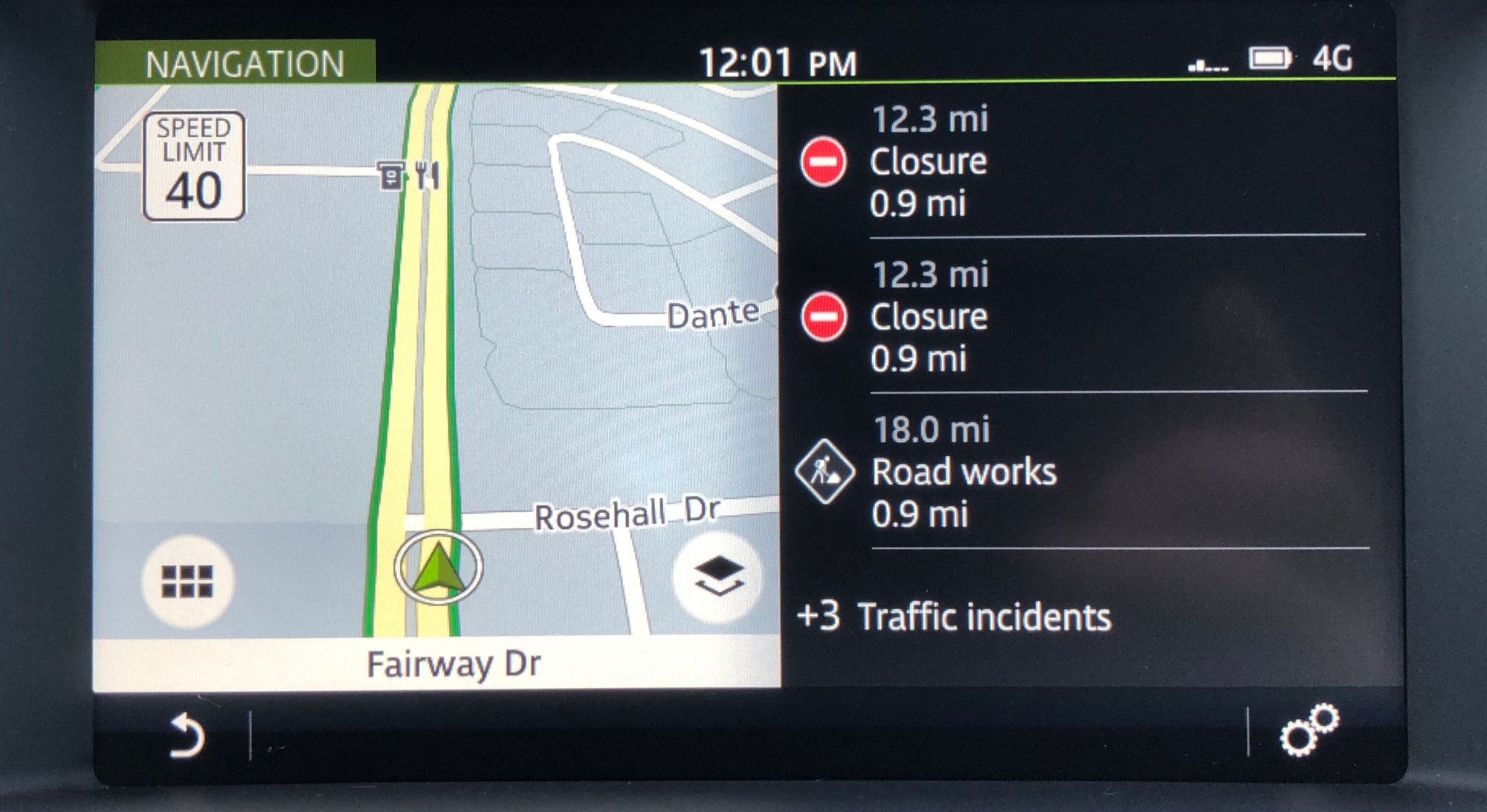

I received my freedompop sim (data only) today and got it to work in my 18MY F-Type. I did have to load/unload SIM card several times (not easy to tell when it is in/out - but the settings screen lets you know). I ended up turning car on so the infotainment wouldn’t turn off. Once I got the SIM card in and the settings said loading, I was able to enter credentials.
The initial card loaded by dealer was AT&T, and apparently freedompop (at least in my area) uses AT&Ts network, the main connectivity settings screen looks same.
I had to click on the network provider option, then turn OFF auto-select to enter the freedompop server/credentials:
after it connected first time it showed 3G in upper right. Then when I was trying to set the limit it said sim not loaded. So I turned mobile data off, then back on and it loaded sim and showed 4G.
i fired up the freedompop web page, logged in to my acct, and the usage showed an entry for today - so seems to be working.
i opened nav and turned on Traffic data and am seeing colored lines around streets!
