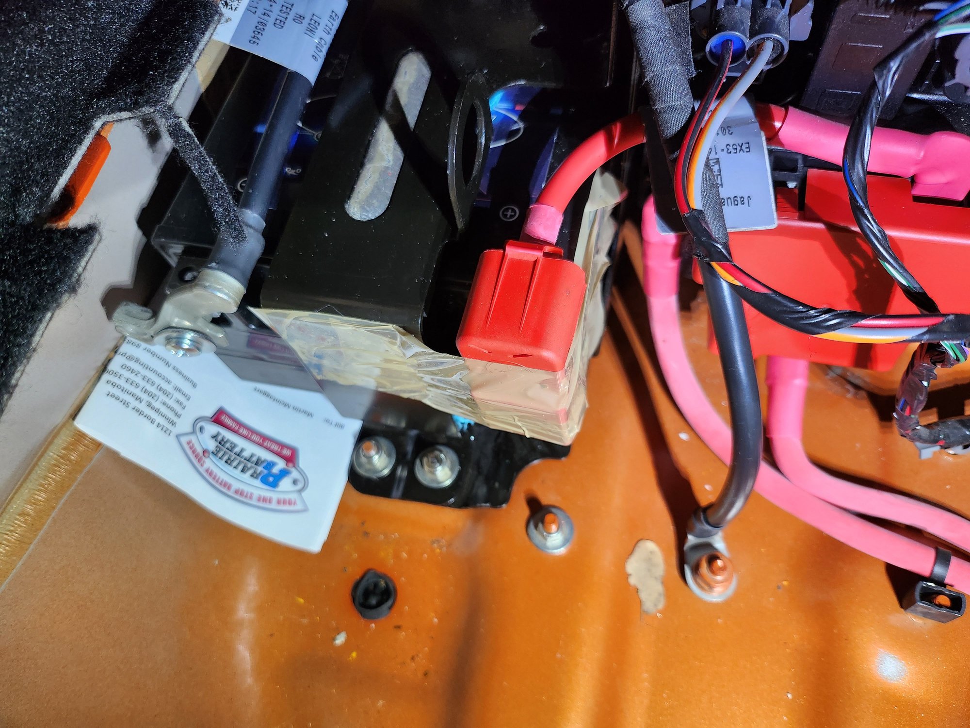

Default Use a motorcycle battery withe the same voltage / amp rating.
Originally Posted by PolkNole
I need to replace my auxiliary battery. It looks like the $40 battery that comes in my riding lawnmower. Jaguar wants several hundred dollars for this little fella. There has got to be a cheaper option. The only one I found online was being sold across the pond in England. Generic options are fine by me. Does anyone have a buy suggestion? Thanks in advance.
Use a longer screw or bolt to attach to the battery. Bolt threw the post hole opening with a washer or two secure it tight. Worked perfectly for me.
