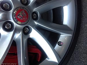

Can’t get more simpler, more tasteful, more “fun”, than these (regardless of the damn photo orientation):
