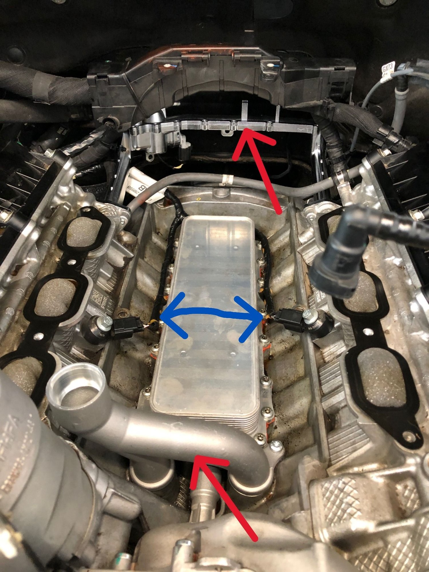

Where is the knock sensor located? I looked around and only found the VOLVO brand turbocharged boost sensor on the left rear wall.
Where are the charge cooler sensors? These are different from the MAF intake sensors near the filter box?
Knock sensors are the blue arrows

@Dionysus thanks for the pic. Since there are 4 codes that point to Bank 1 (O2 sensor, knock sensor, charge air sensor) there may be an issue with the wiring harness/plug leading from Bank 1 to the ECU. Perhaps a coolant leak got into the plug somewhere in the rear of the engine. @TravisBekk Can you Black Light that area in total darkness to see if there is any coolant leaks?
