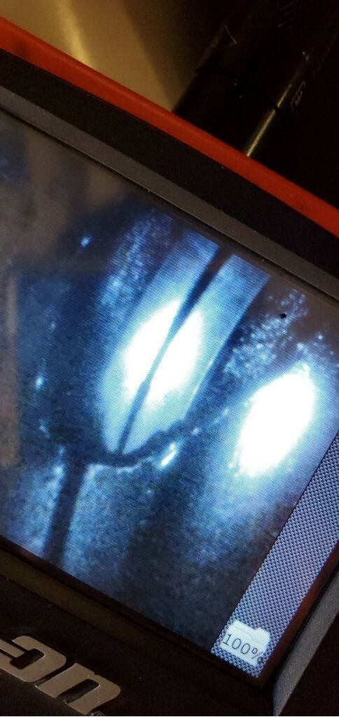

A mechanic sent this Pic of the piston in cylinder 6 .

Wow!!! Yea, that's missing a chunk.
What're your next steps?

I'm not certain what we're seeing here. What are those grooves?
