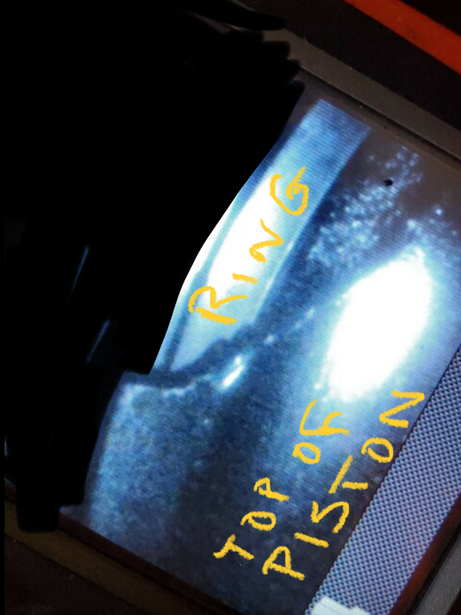

Hard to understand the boroscope photo but it appears that the defect is actually on the skirt rather than the top of the piston. If so, it is hard to see how a foreign object dropped into the bore could have damaged the skirt.
If the damage is to the skirt, then I think the obvious conclusion has to be a defective Jaguar part which may explain why they have been so "nice" about the warranty. I just hope it does not show upas a 2021 model problem!!
no , it’s the top. Easier to tell with the reflection in the cylinder wall blacked out. Compression ring exposed because chunk of top of piston is out .
Lance got the favorable treatment from JLR, I had to pay for my repair!
I put 100 miles on it today! All seems well, the smell is fading, everything seems about normal. It doesn’t accelerate quite as good as the old motor, but it will still snap sideways if not careful . It also isn’t as loud, but the car runs well! I’m happy!
