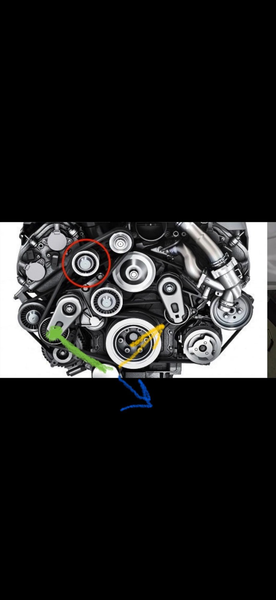

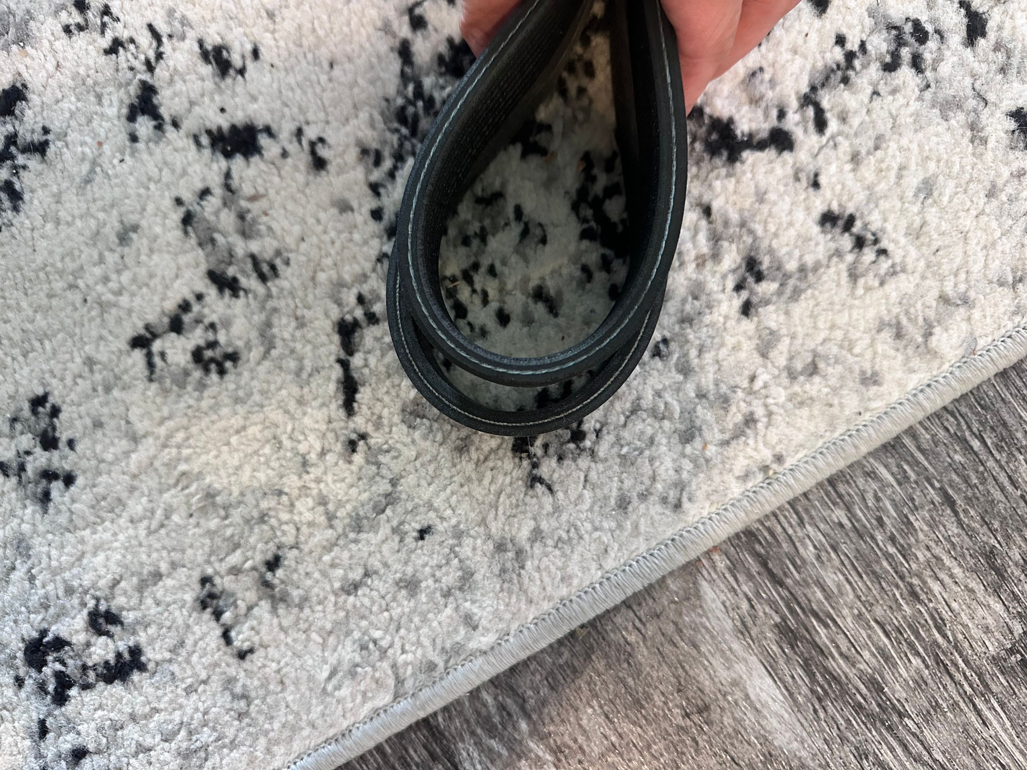

STRUGGLING getting this VelocityAP belt back on and over the pulley system with the new larger VAP lower crank pulley on (yes Im using the velocity AP belt they provided pic of the one they provided is the lower one in the pic and just slightly longer than OEM). Been at it for 2 hours and cant figure it out.
I found tutorials on here as well as YouTube and found two different ways described:
1. Put the belt over all pulleys and leave the tensioner pulley (#2 in pic) until last… the tensioner pulley is EXTREMELY challenging to move (seemed much easier to move the tensioner when i took the belt off).
2. Put the belt over all pulleys except for the idler pulley (#3 in pic) and then pull it over. Idk how you’d even go about this method but tried a few different ways and didn’t come close.
I also tried putting it over all pulleys except top supercharger pulley (#4 in pic) and standing in the engine bay trying to get leverage to wrap it around the supercharger pulley. Not even close
Any ideas? I don’t know why this tensioner pulley is nearly impossible to move more than like 1cm. Is that normal?

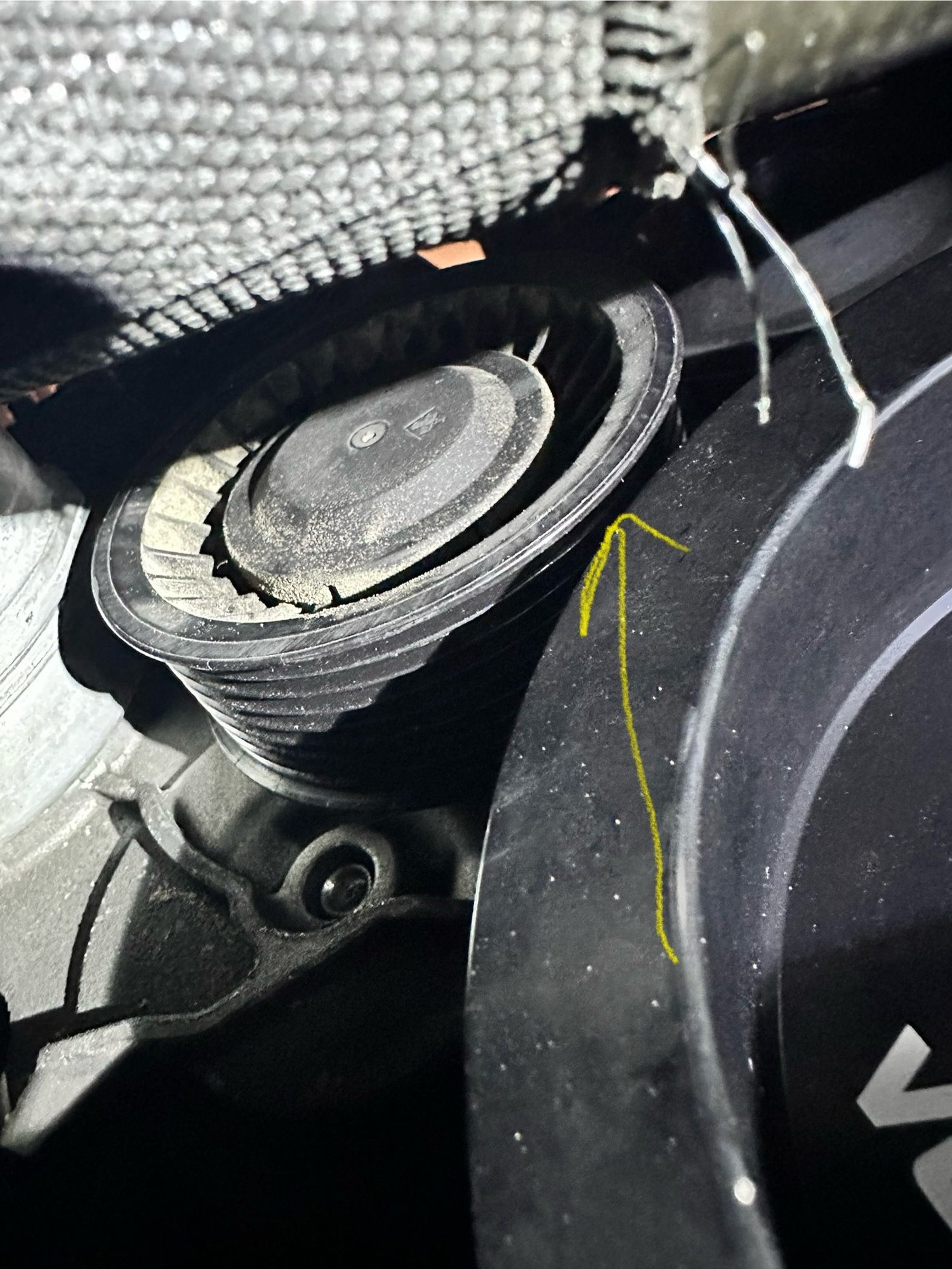

Also, the gap between the crank pulley and the pulley above it is TIGHT. I had to really push/wiggle the belt through the tiny gap to get it seated. Is that normal?
I’m at a standstill here on the install and don’t know what to do.

Never done it myself but I am fairly sure the tensioner (#2 in your pic) should rotate/loosen a fair bit more than 1 cm, my guess is at least 2 or 3 cm anti-clockwise so it is pointing straight down or a little past straight down.
These tensioners are known to wear out and rattle so maybe yours is stuck/fubar?

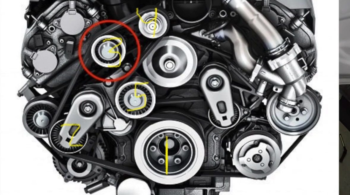

I figured it out. Thank you everyone for the comments. I stepped away from it for a day to give my shoulders and brain a break/refresh and when I got back to it I almost immediately figured it out. I was pulling on the breaker bar attached to the tensioner when I should’ve been pushing upwards. I was using the blue torque vector when I should’ve been using the yellow torque vector. Once I figured that out I got the belt on within 15 minutes

Since I had all the splash shields off, and the car on a lift, I had easy access from below. What I ended up doing was routing the belt over all the pulleys, except the crank pulley. I fed the belt through the gap between the idler and crank pulley, but other wise left it loose. Then I compressed the tensioner while a helper wiggled the belt around the crank pulley. What you are really looking for is which pulley has the lowest lip on it, meaning you need the least amount of slack to get the belt on. But you have to combine that with the practicality of the belt routing. It's pretty much impossible to use the lower idler because of the tiny gap between it and the crank pulley. You also have to balance it with whether you are doing it solo or have help.
Also, double check the belt part number. Mistakes do happen and it's possible you got shipped the shorter belt -- this assume you only did the lower pulley and not both. If you did both, the shorter belt would be correct.
