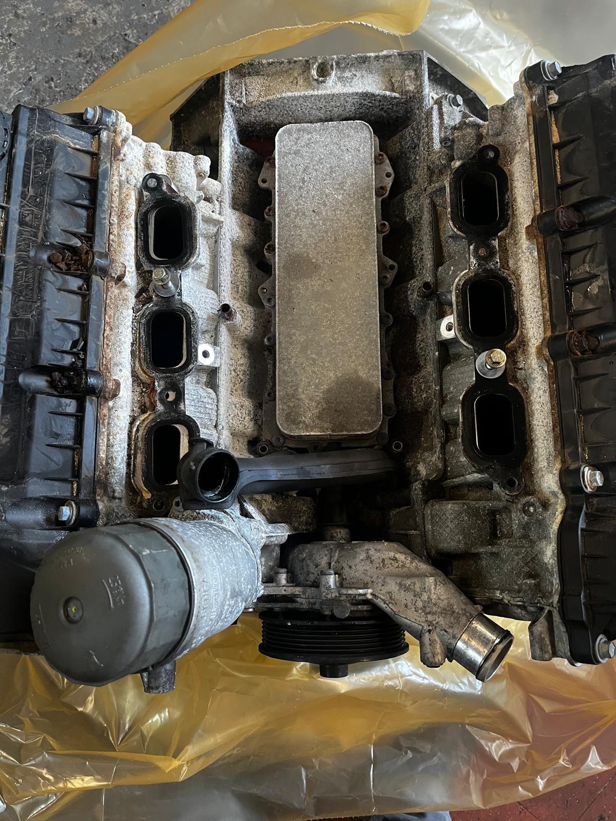

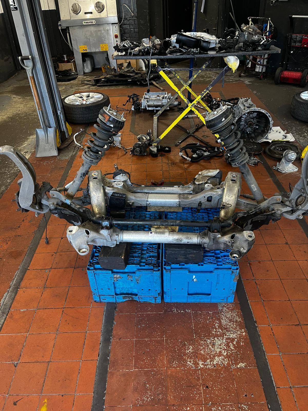

UPDATE: Got the car back on Friday 13th after a long debate with the warranty company that as of now, paid for 60% of the £17K (US$22K) bill. I've escalated the complaint with the UK ombudsman who quickly took on the case and the odds are in my favour. The warranty company based its contribution on the availability of cheaper reconditioned engines supplied by a dodgy company that has had several lawsuits. I insisted on having a JLR reconditioned engine with 2 year unlimited warranty. My JLR specialist, Parkside Garage in Huddersfield, has only ever worked with JLR products since 1989 and they advised against using a 3rd party engine supplier. I'll update this thread later on the outcome of my dispute with the warranty company.
The JLR reconditioned engine came with a new block, pistons, new gaskets, spark plugs and cylinder head. Only the sump was reconditioned. It came with the latest alloy water pump and new oil cooler. I also had replaced:

- I've had the car for 18 months now. The state of the old engine block was truly despicable. I only managed to modify the engine cover back in December so water ingress through the hood/bonnet vents definitely did a number on the block and contributed to the corrosion. It looks almost as if it had been under the sea for all this time! Apart from keeping the modified engine cover on, I might replace the engine vents for the newer "shrouded" design.

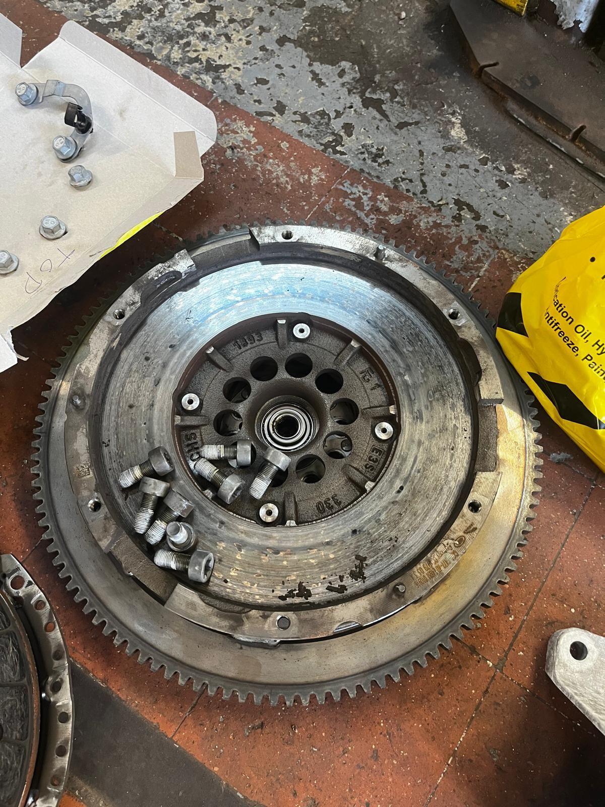

- The clutch looked fine and I debated about replacing the whole thing but that would be too much money (over £2.5K). My mechanic reckons I still have another 40K miles left in the clutch.

Good to see that you got the car back! I know the feeling - when I needed a new engine in the XF I had to spend some 10 weeks without it. Now let's hope the rest of the bill will be covered too.
Interesting to see the old block. Looks like a good example of that an F-Type with the original open base RWD vents and an unmodded engine cover shouldn't be left out in the rain.

So I guess in 8 services they never ever took of the engine cover to do a basic inspection otherwise they would have seen all the corrosion issues. A please explain should be directed to your dealer
The most corroded parts were hidden by the supercharger which I suspect had never been taken out until now.
Old Jun 17, 2025 | 08:02 AM
  #39
CarlB's Avatar
Joined: Feb 2022
Posts: 174
Likes: 95
From: Louisiana
Absolutely. Same issue on our engine.
