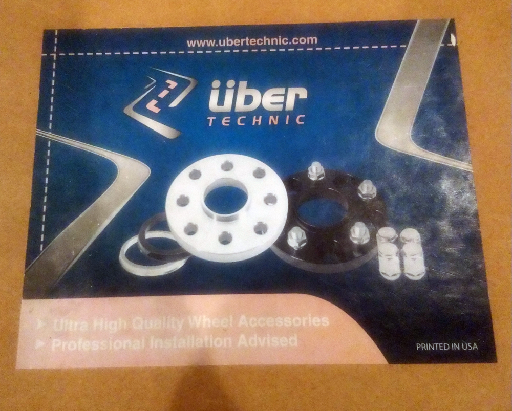

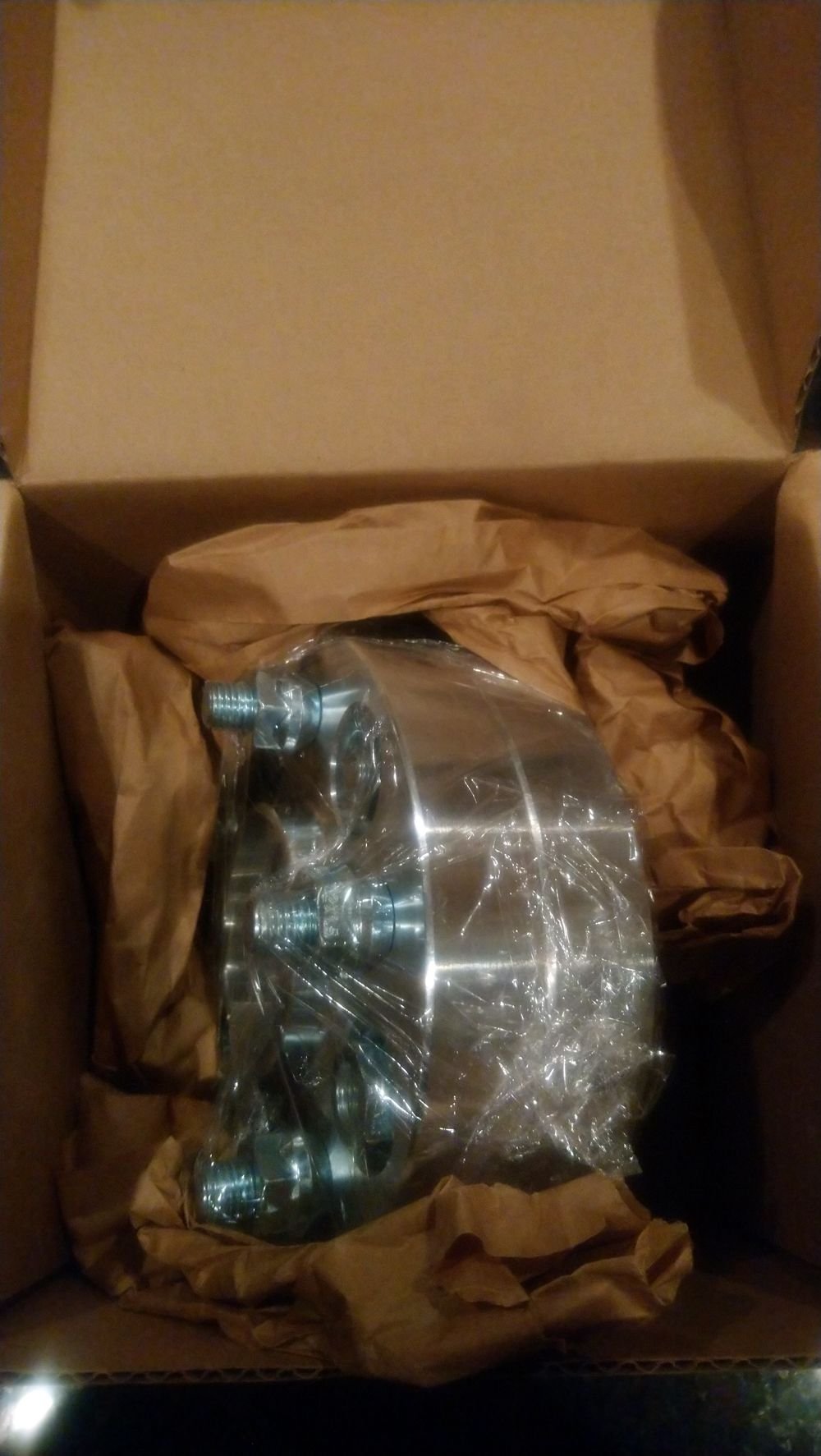

Unhingd is obviously right, but I think its safe to directly measure what you think you need. I doubt it will rub with the stock springs. Hey I have an unopened set of 1" spacer/adapters I bought in case I didn't like the 15mms. You can have em no charge. PM me if you want em..
