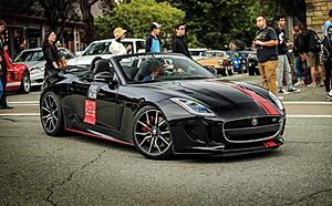

zmoothg I just happen to come across a picture of your car on IG. Your car is looking good man!
Attached Thumbnails SVR fender on R-e9ec5e56-d7a6-464f-8c12-067bc85ee86c.jpeg
Old Jan 17, 2018 | 02:45 AM
  #40
zmoothg's Avatar
Joined: Aug 2016
Posts: 694
Likes: 151
From: San Francisco, CA
Wow! This is a nice photo, better than any photo I have taken to date. Thanks for pointing this out.
