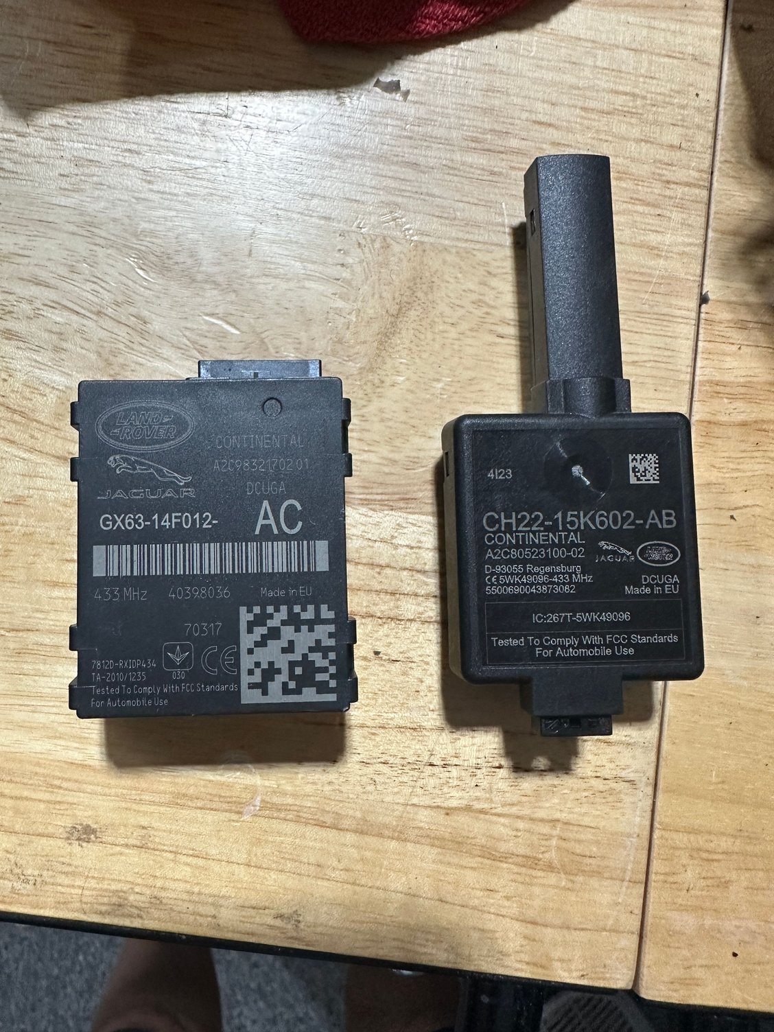

Has anyone had to replace either the TPMS receiver or the keyless entry receiver? I purchased the unit on the left, as a replacement for a faulty TPMS receiver on my 2015 convertible. In every picture or video where I’ve seen someone try to swap out this receiver or even just working on speakers, the square unit is always the one I see. However, when I got behind the seats, the unit on the right is what I found. When looking that part number up, it says it is a keyless entry receiver. OK, fine, then where is my TPMS receiver? is it possible that one receiver is intended to provide both functions and I just need to purchase a new one like the one on the right versus the square one on the left? Thanks.

yes, that’s one of the videos I’ve referenced. It shows the small square unit, which I was told to buy, and yet mine has the one with the antenna. I’m trying to decide if perhaps mine for some reason is in a different location or if the one with the antenna is supposed to do both jobs. Thanks.

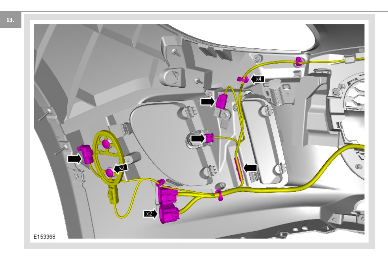

It wouldn't think it does both jobs, the modules are separate functions and would operate on different frequencies.
The TPMS antennas are inside the bumpers on each corner (the yellow oval here). That should be the actual antenna, the device behind the seat is just the CPU. I have a 2014 convertible and it has antennas like the diagram.
