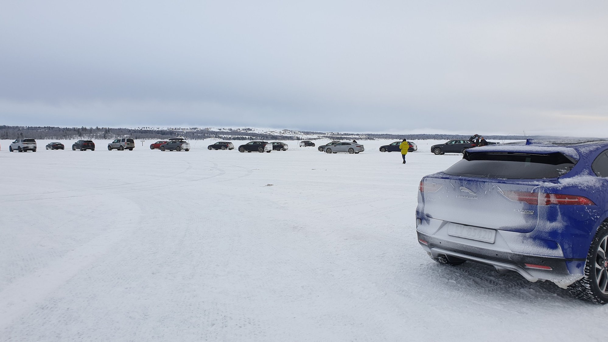

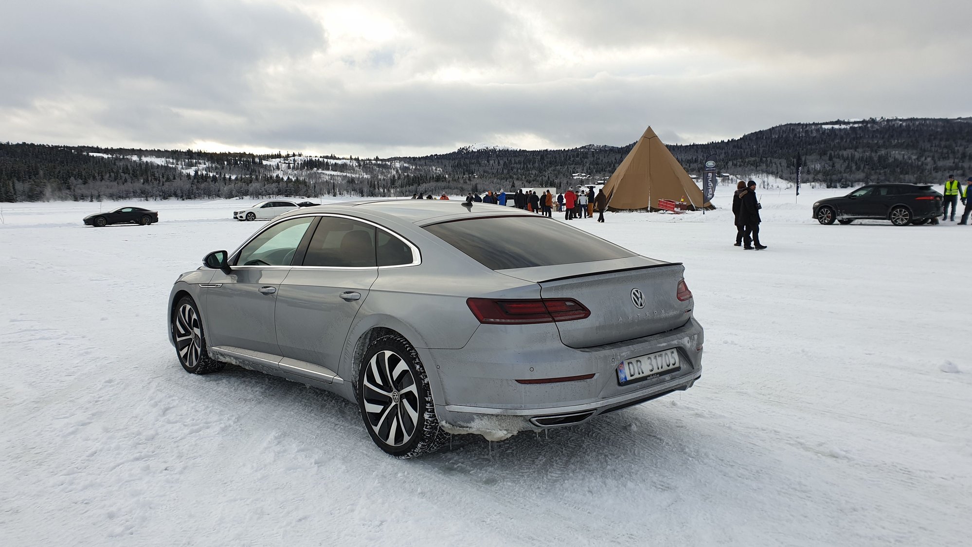

I was invited by the main JLR dealer to an event on a frozen lake in Norway this weekend. We drove most JLR models (including the SVR model from Range Rover and F-pace, and the awd F-type S).
We drove on several different tracks that where made on the ice, including a 3 mile circuit, and a shorter oval drift circuit.
My personal experience with dsc off in most models was that the system would still interfere, and when "very sideways in very slippery conditions", the system would occationally not let you give more power.

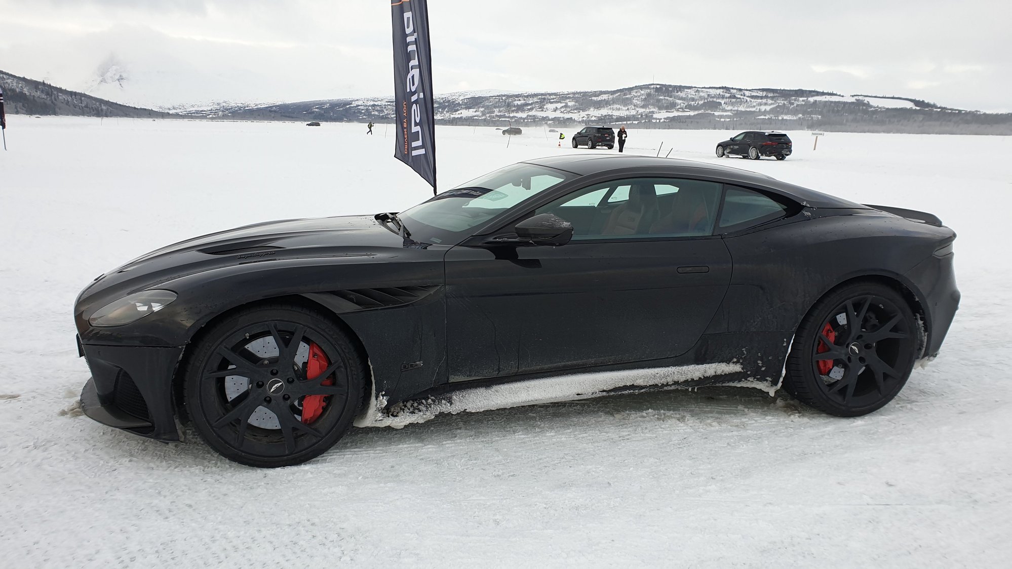

The F-type (and the two rwd Astons - one Superlegera and one Vantage) was the exceptions. With dsc off, I could not feel any interference. The only "problem" with the awd F-type was that it was not always so easy to predict the power distribution between front and rear, which ment that you needed to work a bit harder to hold a long drift and at the same time hold the position were you wanted through the curve. You loose more traction on the front axel when power is shifted frontwards due to very little traction on the rear when very sideways.
It was easier to hit the apex correct with the rwd Astons, as traction on front wheels where more predictable.
Great fun on the ice though 🙂
The Superlegera.
