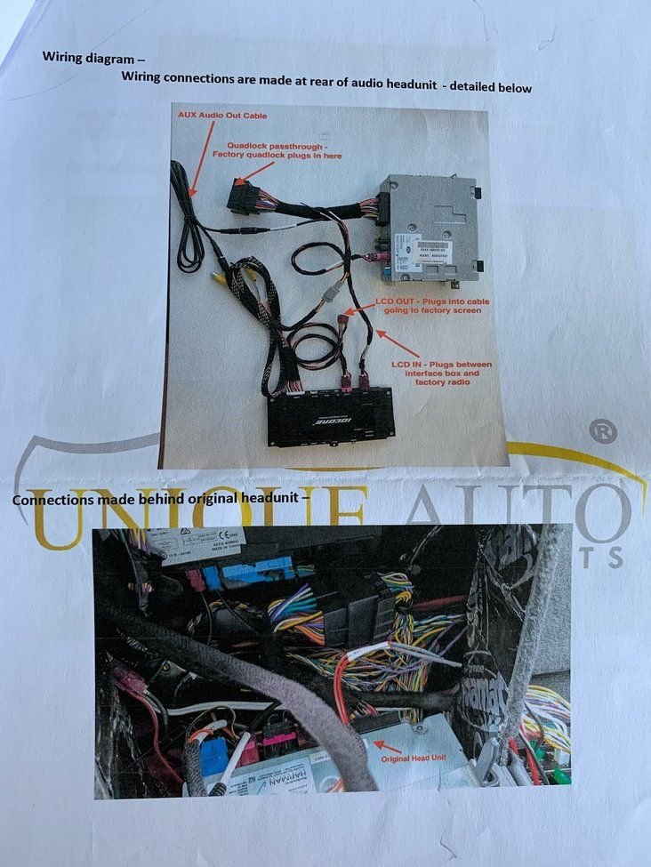

The aux in the centre consol is unused. They give you a blanking plug. Aux connects within the idcore unit. You have to select aux as the source from the screen.

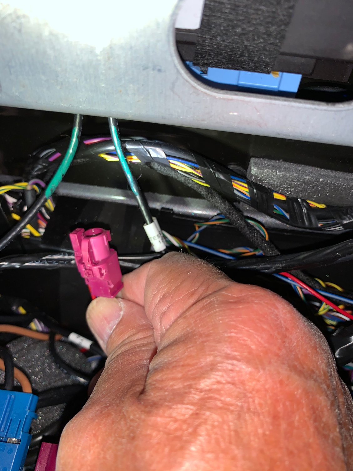

Anyone attempting this for Harman in Coupé…
The pink plug on the Harman is tricky to disconnect. The release lever is on the underside.
I cut off a small bolt and taped it to my finger with a Band-Aid!
