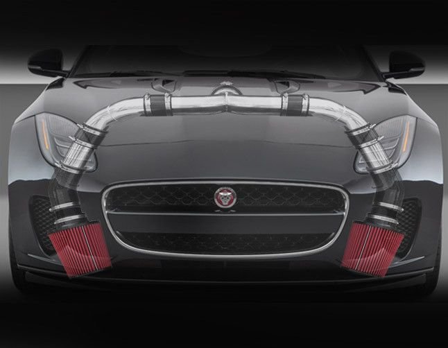

Originally Posted by Iticip
no water got in, so it never got up to the bottom of the door.
I was driving on the high way though, and the intakes are pointed down. Maybe I hit a puddle and some got pushed up?
The stock intake snorkels are not pointed down they are pointed out to the front of the grill, ie horizontal with the ground. Just guessing from memory but the intake mouths sit either just below or just above the level of the grill cross bar so a fair way off the ground. Have you fitted after-market lower intakes such as the Mina Gallery set up, because those intake cones do point down? Either way it is possible for a deep puddle to splash water up into the intakes, especially if taken at speed.
don’t believe I have after market intakes. I bought it used but would think the jag mechanic would have brought it up
bruh lol
Old Sep 9, 2022 | 08:30 PM
Mahjik's Avatar
Joined: Oct 2014
Posts: 1,334
Likes: 392
From: Kansas City, MO
bruh lol
You do realize that is the image for the non-stock Mina intake?
https://minagallery.com/jaguar-f-typ...-tube-filters/
Oz's comment is about the "stock" intake...
