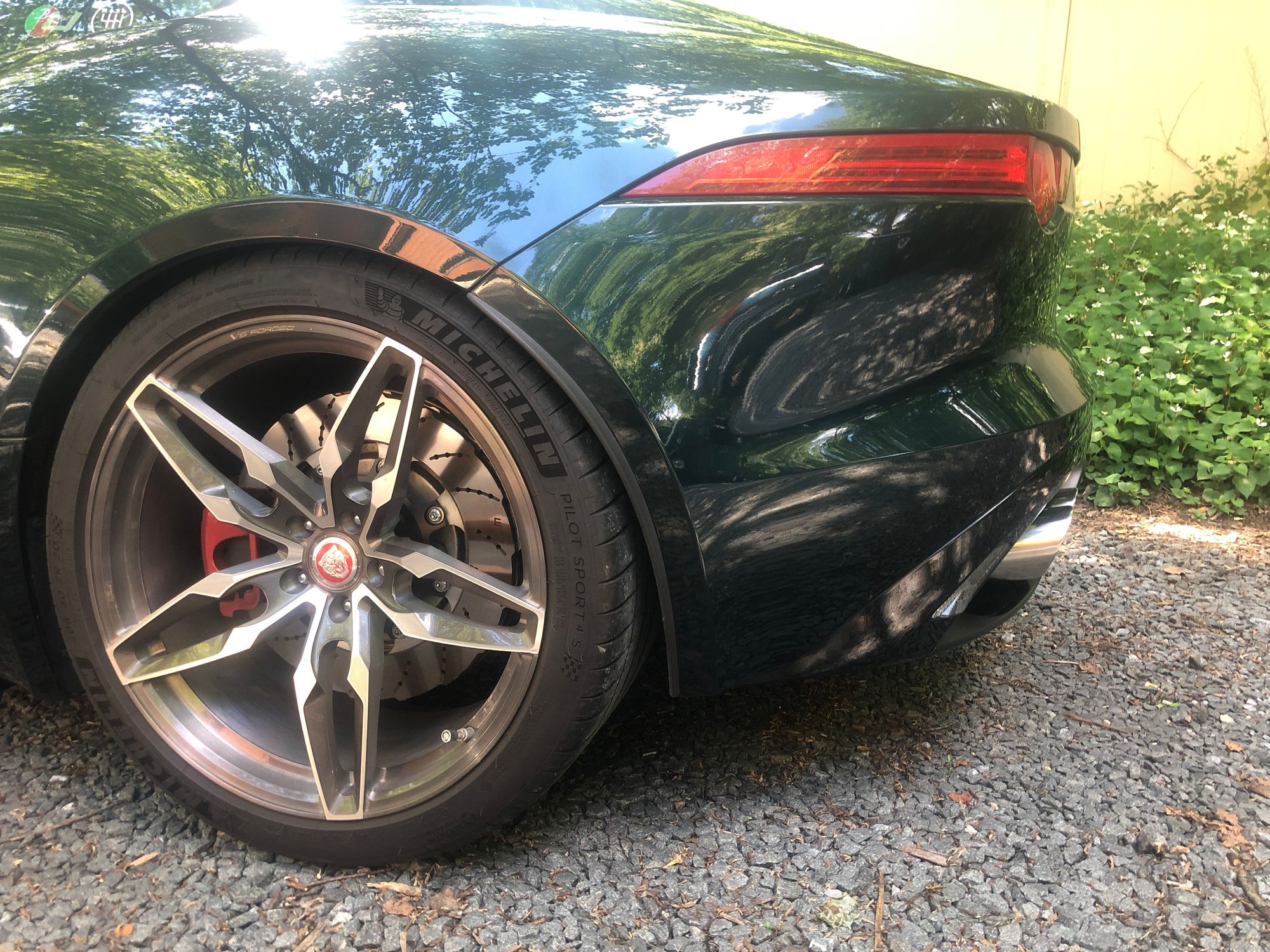

Are you certain you don’t have the larger 376 mm rotors in the rear? I do on my MY16 with SPB & TVB.

Well, now that you mentioned it, I never measured them. However, they look very unsexy so I assumed they are vanilla calipers. Unlike fronts, that look the part.
If you have 376, can you post a picture of yours? My car is in offsite storage for the winter.

The rear calipers are certainly pedestrian looking.

Yes, this is how I recall my rear calipers look. I will measure them in the spring to make sure.
Also, not at all smooth surface and hard to keep clean because of that. Yours look much cleaner than mine, how do you keep them this clean?
