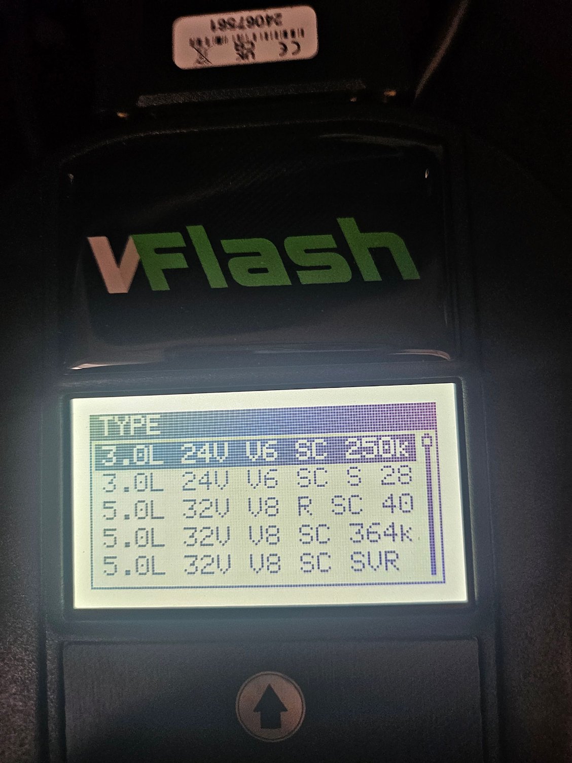

I have a 2014 f type, 5.0 495 HP. Does anyone know which of these three 5.0 options I would select when downloading the factory map?

Does it scroll down? Yours is technically a V8S, assuming it’s a US car.
The one that says 364KW, which should scroll the text to show MED17.8.31, although any of them that say MED 17.8.31 should work.
