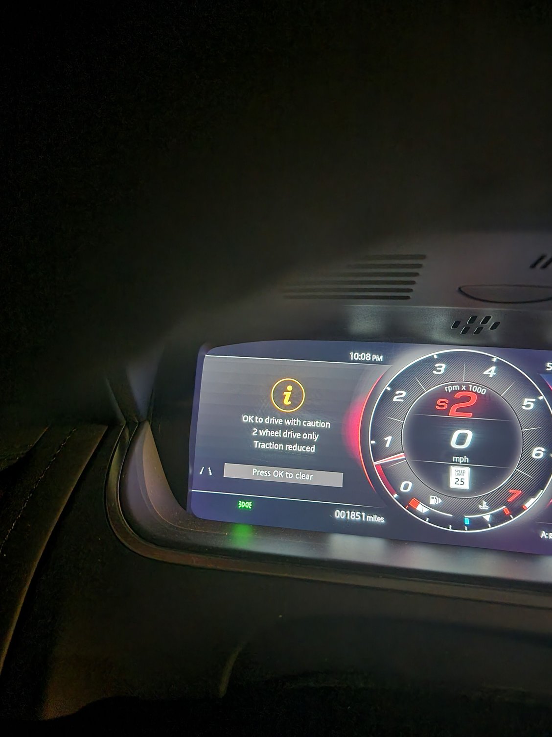

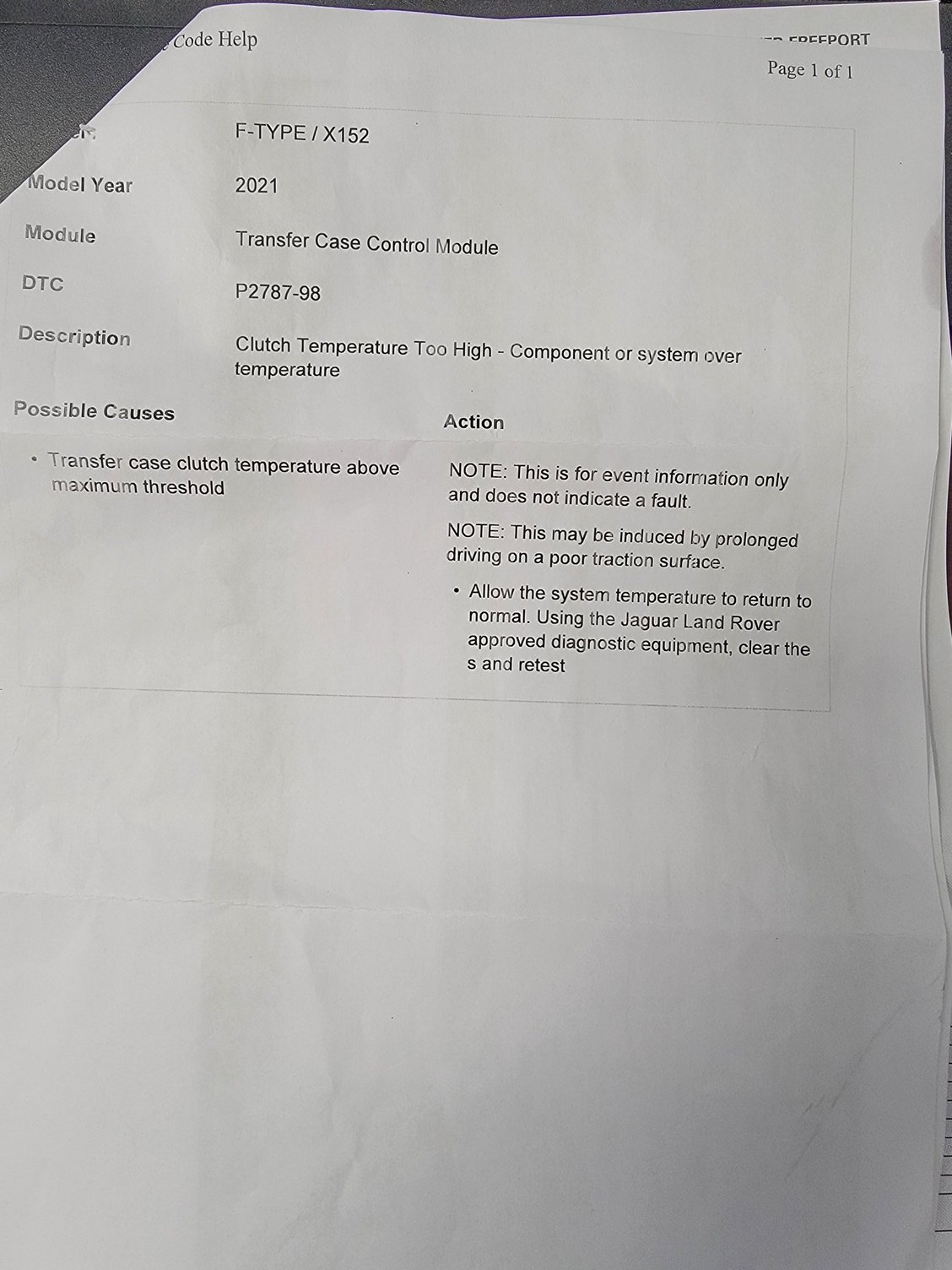

Hey Guys. So just got back from the dealership after this issue I've been having. So when launching in tracdsc or traction control fully off I get this message on the dash regarding "2wd only traction reduced" and then turns full traction control back on. It also throws a P2787-98 code when i used my OBDll reader that stays there. So I get a phone call from the dealer saying the technician looked into it and nothing was wrong. When I got to the dealership I insisted that I would like to speak to the the technician who looked at the car. He says this is "completely normal" and that jaguar say this is code "does not indicate a fault. I tried to explain although Jaguar might not be claiming this as a "fault" tracdsc should not be turning itself off and then storing a code on street launches claiming transfer case overheating if there wasn't an issue. He didn't want to hear any of it and kept insisting jaguar says the code does not indicate anything wrong. Next closest dealership is over an hour away from me.
So to my fellow F type friends is this normal? I've attached pictures of what comes up on the dash along with the print out of the code the dealership gave me.

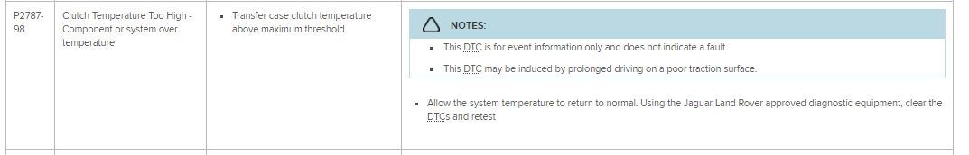

Here is the code description from Topix
This is what the tech would have looked up. Did this warning come up after 1 launch or had you done multiple launches??

The code does say to do nothing an let cool down, strange. Remember dealers don't like to do work they don't get paid for. At our Maserati dealer they only give loaners to customers that service car there.If this is the selling dealer they should want to correct this as good business. Wonder why dealers don't do updates before delivery.
