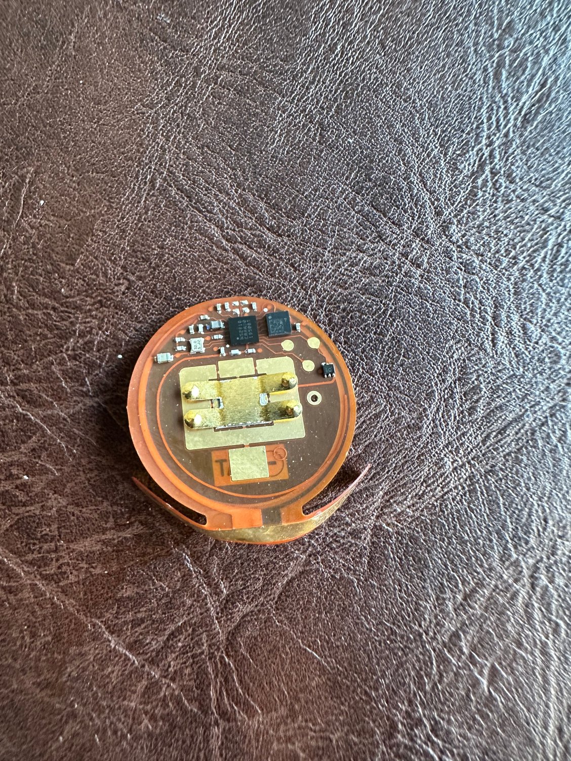

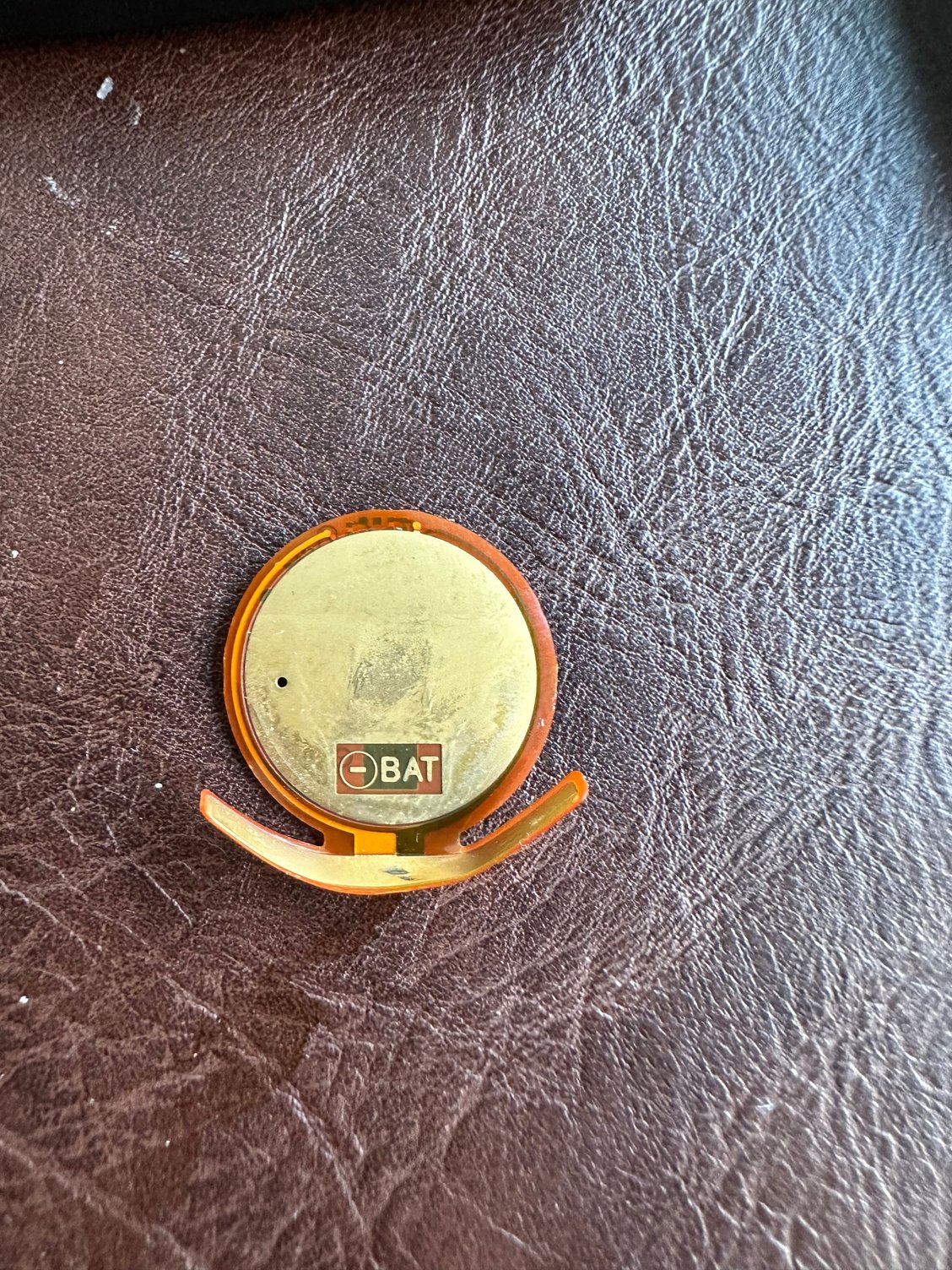

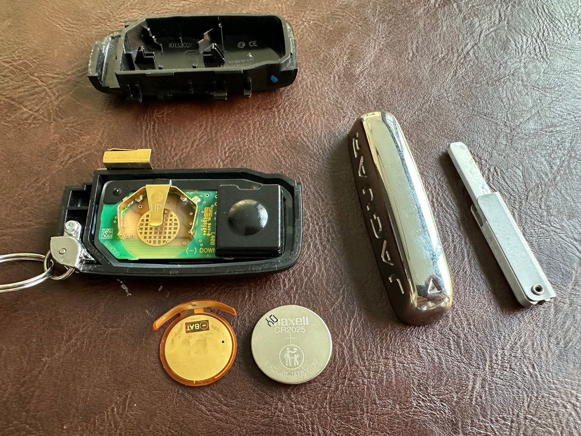

The battery in my key is running low, so I wanted to replace it.
When I opened my key, I noticed a small circuit board located under the battery.
But what is it? Is this original?
I bought the car second-hand.
Originally, it should have a CR2032 battery, but now it had a CR2025 battery.

Looks like an immobilizer transponder.

I just got a reply from the dealer.
It appears to be part of the anti-theft system. It disables the keyless entry signal after 5 minutes of no movement.

Interesting. It probably extends battery life too.

It's a smart idea to prevent relay attacks on wireless keyfobs, especially the JLR ones which are a popular target.
There's a few options like this:
https://www.sleepingbattery.com/en/home/
