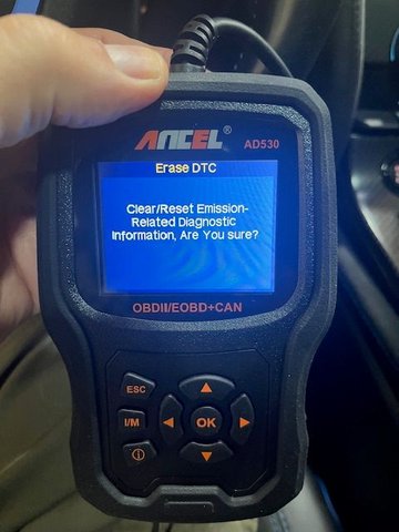

No codes in for 3 years (O2 sensor replaced in 2022). Car is running like a clock and check engine light came on during an unusual warm day from where I am from (90F). A number of re starts and drives, it continues to stay on. Car sounds correct exhaust wise, no change in power band and power is not diminished in any way, no weird noises and no smelly exhaust so not thinking the Cat. Used the OBII and it pulled up the P0420 code and asking it diagnose it just gave me a bunch of stuff from filter, to exhaust leak to cat ..etc including filters ..etc.
I service the heck out of this vehicle via the dealer and OCD and having everything freshened up. .
Before I bring it to the dealer (have warranty), should I get rid of the codes and see if it stays away and maybe its a was a one time blip or leave it coded and bring it to the dealer next week. If it comes back it will be at the dealer pronto.
Thanks in advance.

Thanks for the info and it is helpful. I just confirmed that the original owner (who is a friend) had the CAT replaced under warranty in Sept 2019. That might explain the code that says permanent when I checked it out. Could it be a legacy code that was there from back in 2019? I had just filled up with fuel and it was about 10 minutes later that the code came on. Could it be just the gas cap is an issue? When I clicked on delete codes the evaporative message came up. I did not delete. After a bit the other messages showed up. Trouble is I am days away from getting a gas cap for an F-type where I live... Love to try the cap and if it goes away all is good. Still will bring it in this week so I won't clear any codes.
If you had the CEL light up, then it is not a legacy code. Permanent codes are not stored legacy codes, a stored code could be, but not a permanent one. I cannot comment on the gas cap thing since I haven't dealt with that before. I would think a evap code would be a totally different number than a p0420. P0420 is pretty much exclusively the exhaust system.
A p0420 is not an evaporative emissions code, Those are more like P0456, P0442, etc. and can sometimes be caused by forgetting to tighten the gas cap.
You might have been confused by the message in your scan tool screen - "emissions related". All (or any) power train fault (any P-codes) are emissions related. At least to the EPAs they are. Any failure of any system in the power train that causes it to operate less than 100% as designed is considered to impact emissions.
