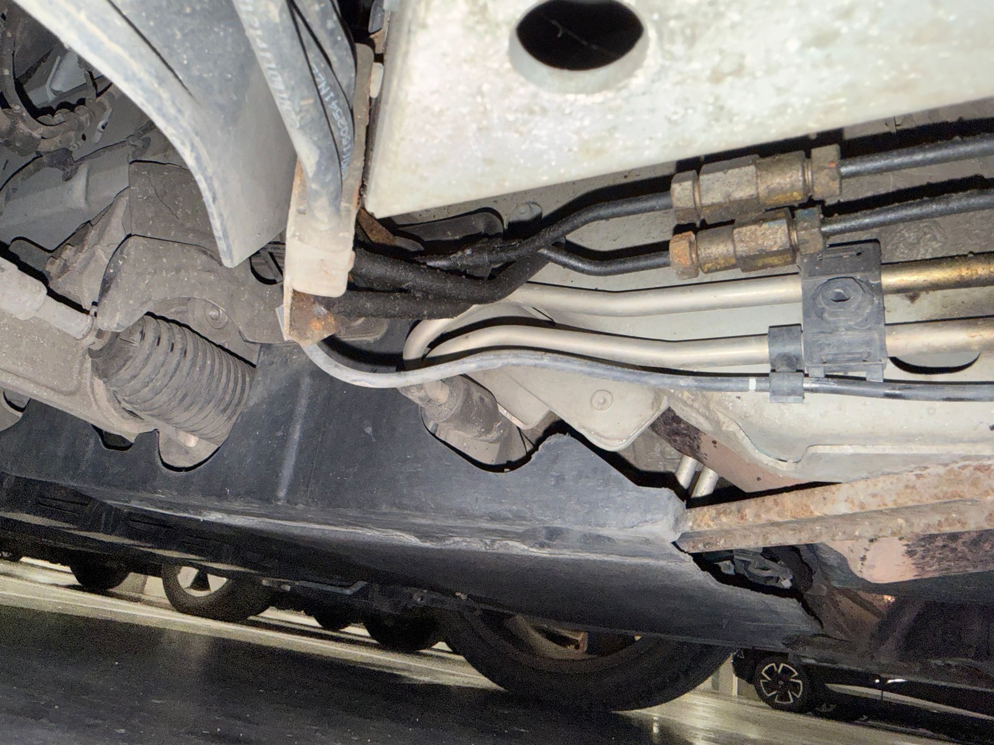

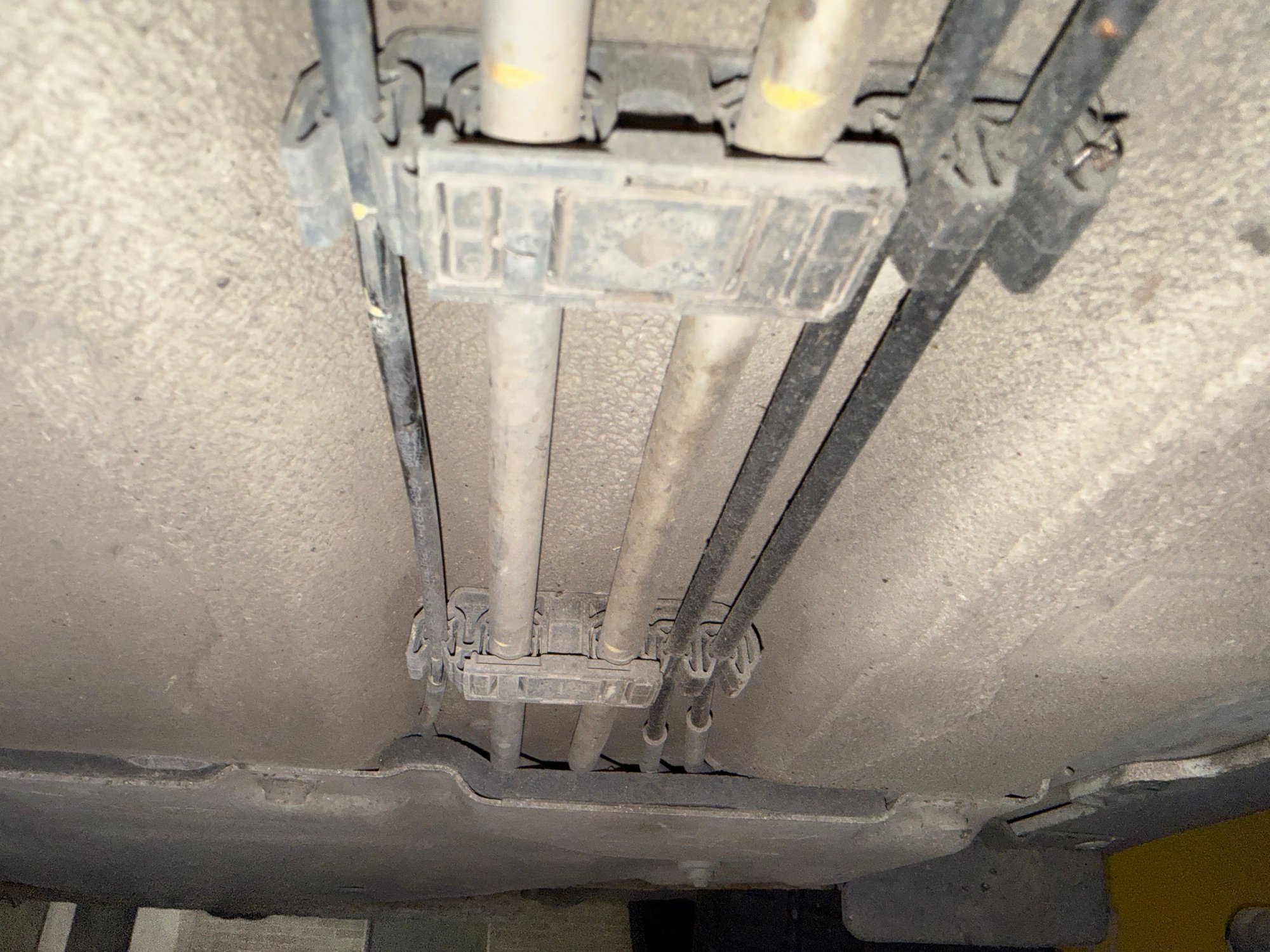

I’m trying to identify the black cables/lines running along the underside of my Jaguar F-Type V6S 2015 UK RHD, shown in the attached photos. (Top picture is not mine)
One of the black cables/lines was slightly sagging down from its clip/route, and I’ve been getting a tapping/rattling noise at around 70 mph. It sounds almost like a wire or cable bouncing against the body or undertray, so I’m wondering if this could be the cause?
Thanks!

I think one is a purge line from the engine purge valve to emissions canister on the fuel tank.
The other two might be the vacuum lines to the active exhaust.

Nup, not parking brakes. All F-Types have electrically operated parking brakes with a small electric motor on each rear brake caliper so no cables.
I'm going with IRRX152 that they are the active exhaust valve vacuum lines.

Left to right in your picture
active exhaust vacuum line
fuel feed line
fuel vapor return line
left rear brake line
right rear brake line
I think that's the right sequence, but the hose you are asking about is a vacuum line.
